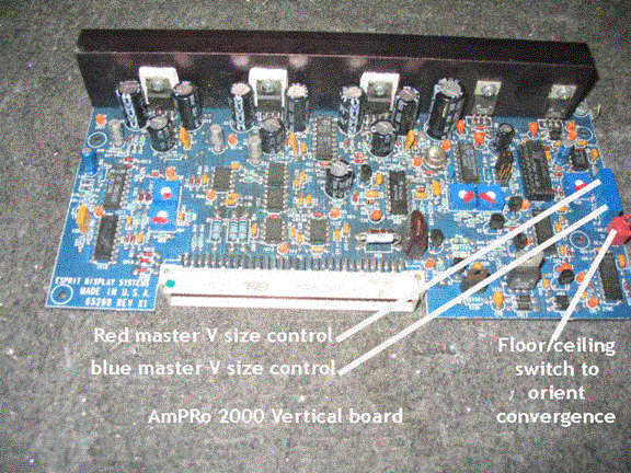

Vertical Oscillator and Output Board:
![](images/Ampro2000image008.gif)
This is the vertical oscillator and output board. This board is fairly
reliable, but fails from time to time. If one of the LV power supply fuses blow
continually, I’ve had this board short out.
Two critical adjustments on this set are the master R and B size controls. Do
a ‘55’ code, to turn off the registration, and bring upt eh crosshatch test
pattern. Adjust these trimpots to adjust the overall height of the R and B
images to match the size of the green tube. That will minimize convergence drift
over time.
The toggle switch is to be set according to the Ampro manual. This ensures
that the convergence controls work correctly depending on whether you’re set for
floor or ceiling mount. Note of course that the convergence connectors on the
yoke board also need to be set correctly as per the manual.
