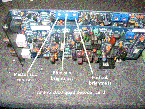

Ampro 1500/2000
Quad Decoder Board:
![](images/Ampro2000image006.gif)
The Ampro 2000 quad decoder board only has the three trimpots as labelled
above. This board converts any format video signal to the RGB components to send
to the RGB board. This board does have issues from time to time, including noise
in the video signal, no color, and other assorted issues. Note that the S-video
input connector must be selected from the keypad via the manual before it
becomes active. The unit may also glitch and force itself into monochrome or PAL
or SECAM mode, the remote should read ‘quad auto mode’ to work properly.
