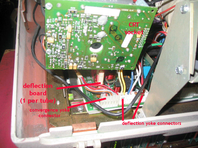

The below image shows one of the CRT output sockets. These pull right off the
back of the tube, and all connectors pull off the board. Note that there are
three single pin connectors right beside each other on the component side of the
board with the exception of the focusing wire that pulls off the back of the
focusing board. Ensure that the two black wires go back onto the right pins, and
that the G2 wire goes to the third pin. Sparks may result if these wires are
incorrectly installed.
![](images/ECPimage004.jpg)
All three CRT sockets are identical, so if problems occur with one color,
these CRT boards may be swapped around to eliminate them as a source of the
problem (or to confirm it.).
