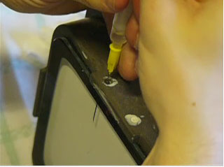

Now take your syringe (with a small diameter needle) and slowly insert it
into the hole. Don’t be surprised if there is glycol splashing out at this
point (though in the video it just slowly leaks out).
Make sure you remove the leaking glycol right away, as it is a real mess
to get it off the tube face, or off components. Glycol is also corrosive, so
that’s another reason to quickly remove any spills.
When you have inserted the needle far enough, you will actually be able
to see it when looking at the tube face.
Now start to gently extract some glycol. This should be very easy.

![](images/Bleeding_Tubes4.jpg)
Step by step video: Bleeding_Tubes4.MOV (23.3mb)
