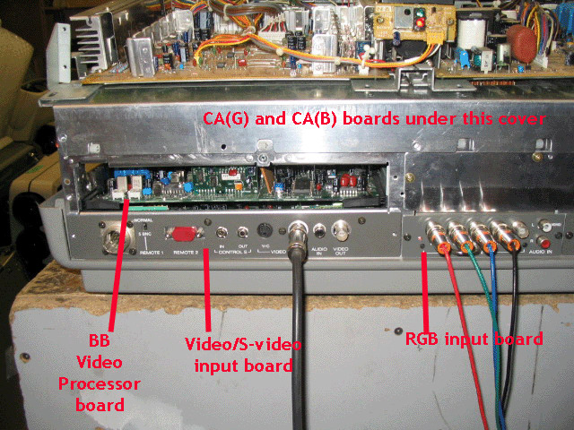

Looking at the back of the set, a blank cover hides the BB board which
contains video processing circuitry. The video/S-video input board is located
under the BB board. The standard RGB input board is shown to the right of the
video input board. The video output boards are located under the metal shield
over the BB board.
