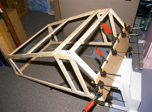

After determining that the frame fits the projector, I start gluing on
hardboard pieces that are cut to fit:
![](images/hushbox6.jpg)

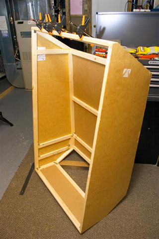

Use wood glue and plenty of clamps (you can never have enough!) to ensure
that pieces fit tight.
Most of the panels have now been attached:
![](images/hushbox7.jpg)
