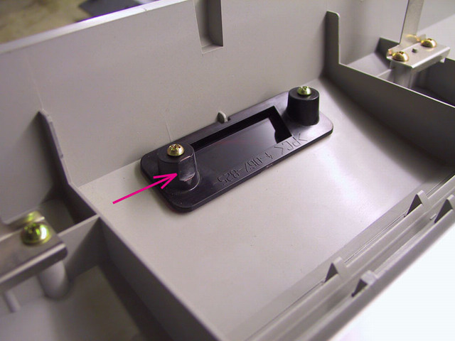

9. We now need to modify the grey plastic housing to make the fan fit:
![](images/G90_fan_mod_image10.jpg)

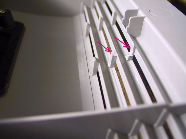

10. We also need to modify the red IR plastic to make the fan fit:
![](images/G90_fan_mod_image11.jpg)
