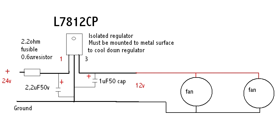

I used these in My Marquees LVPS:
http://www.enermax.com/english/product_peripherals.asp
the marathon 120mm ones not sure what the ecp has. Just make sure the CFM and pressure ratings are the same as the original. If the ECP fans are 24 volt you will need to make a step down viltage regulator. not hard to do.
The warp fan is new and I just saw it looking up the web site for you. I might try these now in my belly fans.
step down voltage regulator to 12 volts DC.
