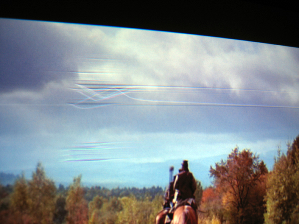

Good evening ladies and gentlemen, this is what the image displays after about 30 to 40 minutes into a movie. The 909 is fed by a PS3 to a Moome external HDMI and to the 909 RGB port 5. She has high mileage on her but breathtaking image when functioning properly.
It starts off with a small slash or strange scan line about 6 inches long horizontally then spreads to other parts of the screen. They appear on the face of all three tubes.
I do not have a service manual and cannot identify all the boards but this is what I tried so far.

When I unplug the convergence board wire harness (multiple yellow wire with white connector) from the controller in the convergence tray, the lines goes away. I’ve tested some resistors and swapped a few caps on the board but no good. I am not a EE just a hobbyist with a meter and soldering gun that enjoys watching movies on a FP CRT. If any experts or someone that experienced this before can chime in on a fix or things to try it would be definitely be appreciated.
-Tim

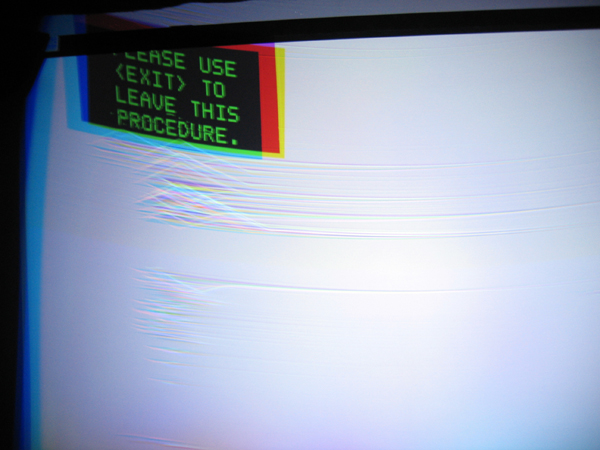

reset all to midpoint with white field, geometry not set

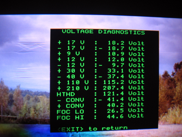

voltage diagnostics
