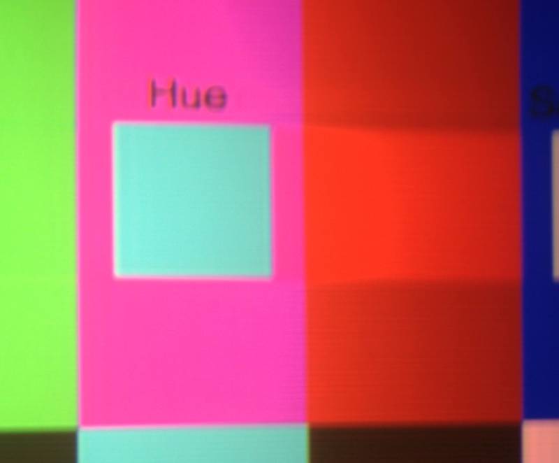

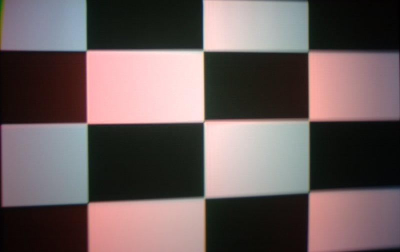

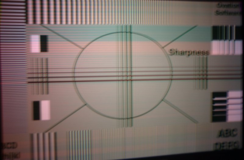

Here are some pics of what I am getting on all sources (including component). These are shots off the Avia DVD. Except for the color chart one all the test patterns are supposed to be B&W only. The color chart one shows the streaking. I have tried all new high quality cables and it does it with a computer monitor also. Does same thing from Directv H20 HD receiver and Toshiba A2 HD-DVD.
Notice the streak and color blotches..

Posted: Tue Mar 25, 2008 3:19 pm    Post subject:
Joust wrote:
But Kal is right, the very first step is to send a mail to moomefix@curtpalme.com.
write up as much detail as you can and screen shots would help. A picture is worth 1000 words.
Yes, Moome's said that anyone that has colour problems (or other problems) should email him with complete details.
Best to send him the photos too instead of linking him to the forum as he has problems accessing this site reliably for some reason.

Posted: Sat Mar 29, 2008 11:37 am    Post subject:
Dave,
what resolution did you use?
I see similar effects when feeding 1080p from my ep30 HDDVD. I think it has to do with the porches. I also have wrap around on both edges. With 1080i and 720p all is fine.
