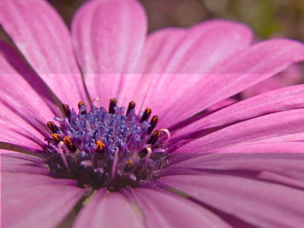

I have a big problem with my ECP4100.
I did dissapear one time befor, when i did hard reset.
Then i was gone, but now itīs back.
And hard reset wont do nothing.
Pleees help me!! itīs drives me crazy, itīs not notible on all scenes in movies.. but itīs there..
Attached image is to explain what i looks like.

Image display problem.
3 different zones of darkness and middels one is the "light" part.

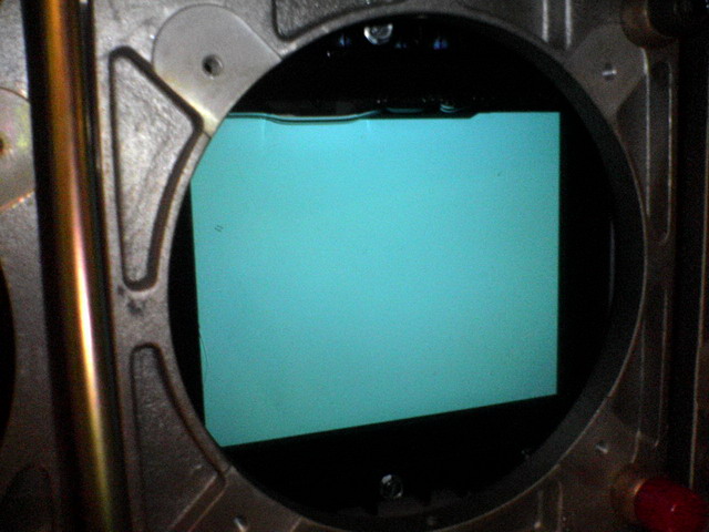

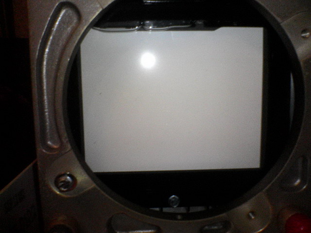

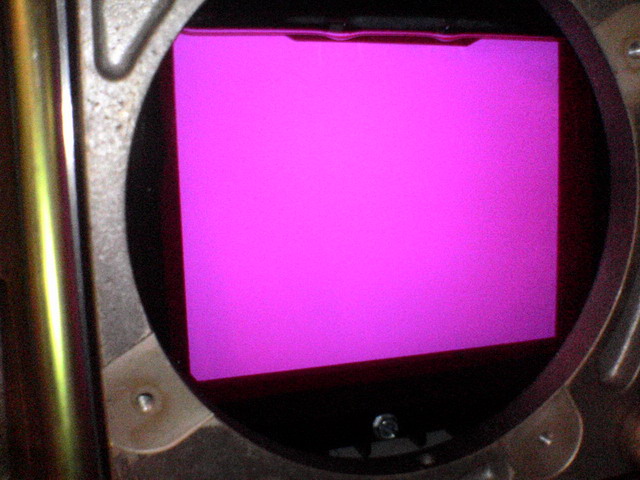

My tubes
Gree - Red - Blue
Not a burn in problem....
(i suck with the digital camera.)
Pleas any one this is driving me crazy..

Posted: Tue Mar 18, 2008 9:07 pm    Post subject:
Your tubes are fine. It's not a tube problem. Hopefully someone familiar with ECPs will chime in.
