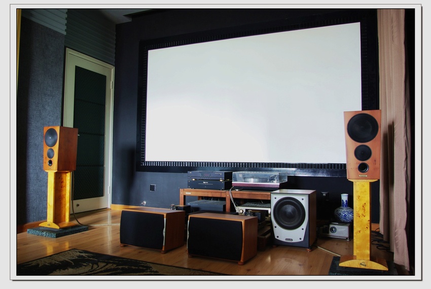

in recent days,my barco 801S got some problem,always auto shut down when running up to 20min,it could be turned on again ,but soon shut down again,happen couples times a night ,i can not finish a movie.
i can make sure the tube,HV quadrupler and EHT board is OK,and input board,video/rgb board,quad decode board and power borad,foucs board all fine,when it running,the picture is good ,the problem must be one of h shif board,h output board and V board,but i don't know which board problem of that three could cause machine shut down, so i can find other one to replace it.
please help,thans.

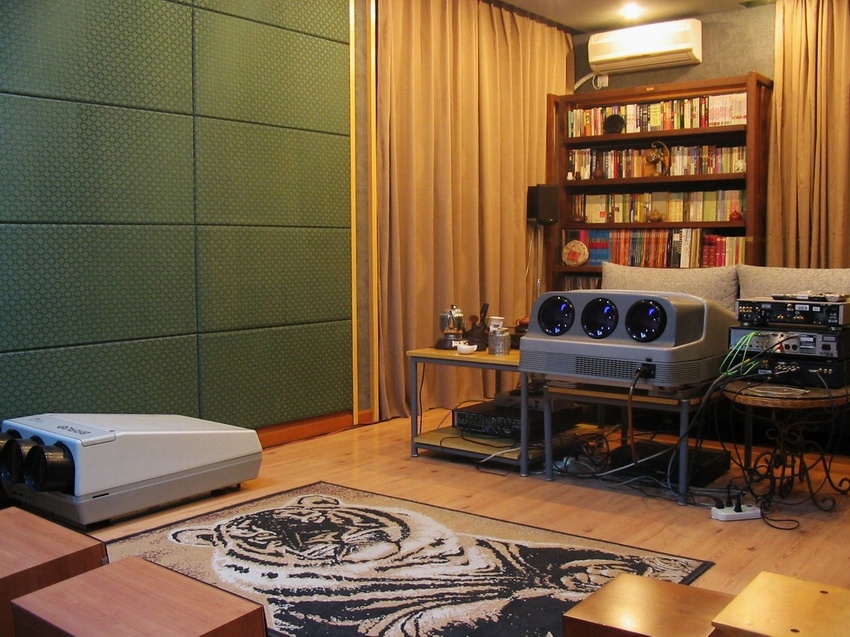

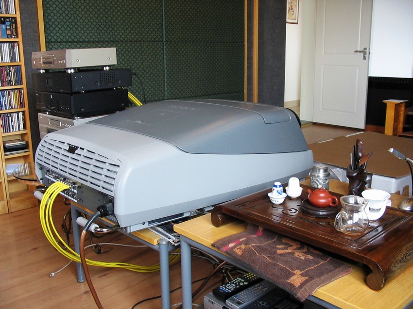

Posted: Thu Mar 13, 2008 6:21 am    Post subject:
thanks,curt,you really got sense of humor,actuelly i can offer pic of G90U in my projector room,maybe it's tube envy cause the problem.
i have unplugged the EHT board and HV quadrupler for test,when turn on the machine,801s still shut down in couple mins,so i think it has nothing to do with EHT board and HV quadrupler .
and i remove the cover of projector when it is running,and i can see the red liting on the V borad just before shut down.so i think the problem must within the 3 h and v board.
i have friend with these boards,next week i will have to exchage for testing.
thanks again.

Posted: Thu Mar 13, 2008 12:03 pm    Post subject:
What happened to the 1292 in the first pic?

Posted: Fri Mar 14, 2008 1:43 am    Post subject:
i have sold 1292QM in 2006,the green tube of it has serious wear and fan noise is too loud to put up with.
and the G90U is not mine,it belong one of my friend,i have used it for monthes.

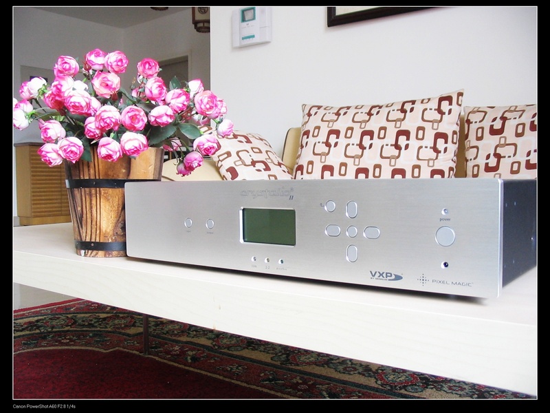

Posted: Fri Mar 14, 2008 4:17 am    Post subject:
I wish I had friends like that Mr. Green
my friend is very generous,also let me use his PMS vps-3800c2 video processor,by the way,i have a vps-2300 with sdi output papasonic S688 dvd player.
