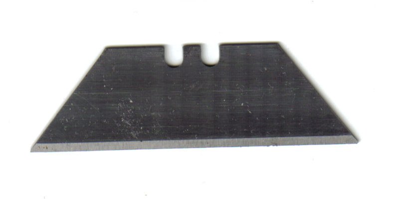

That's way to much silicone. When I did mine ( I had a pretty purple arc over an inch long ) I just used a knife blade as seen in my pictures here:
http://www.curtpalme.com/forum/album_page.php?pic_id=294
http://www.curtpalme.com/forum/album_page.php?pic_id=294&mode=next
http://www.curtpalme.com/forum/album_page.php?pic_id=295&mode=next
http://www.curtpalme.com/forum/album_page.php?pic_id=296&mode=next
and there's a how to here:
http://www.curtpalme.com/HV_Lead_Removal.shtm
Here's the blade I fould that worked best. It's stiffer than a regular single edged razor blade.
