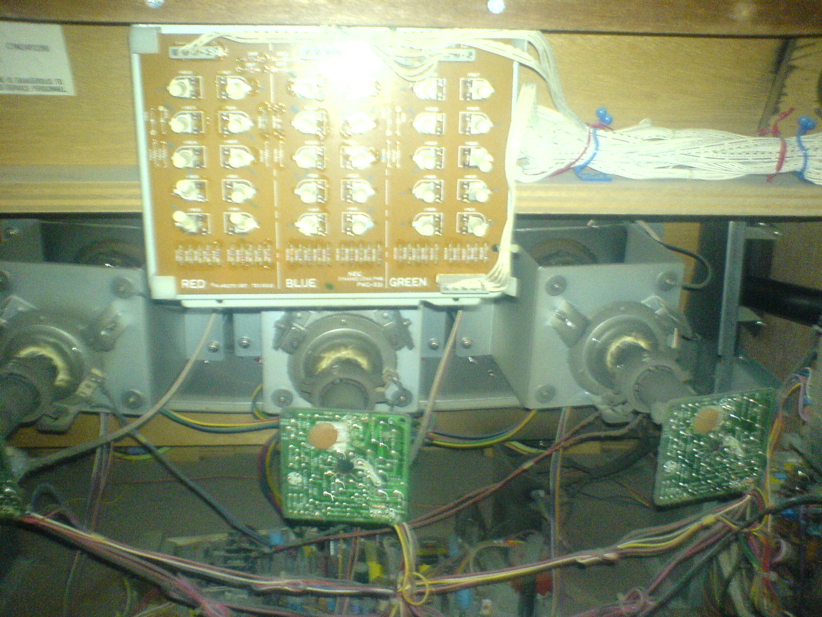

It does have video input and I hooked up a dvd player and the picture was there but really really bad.

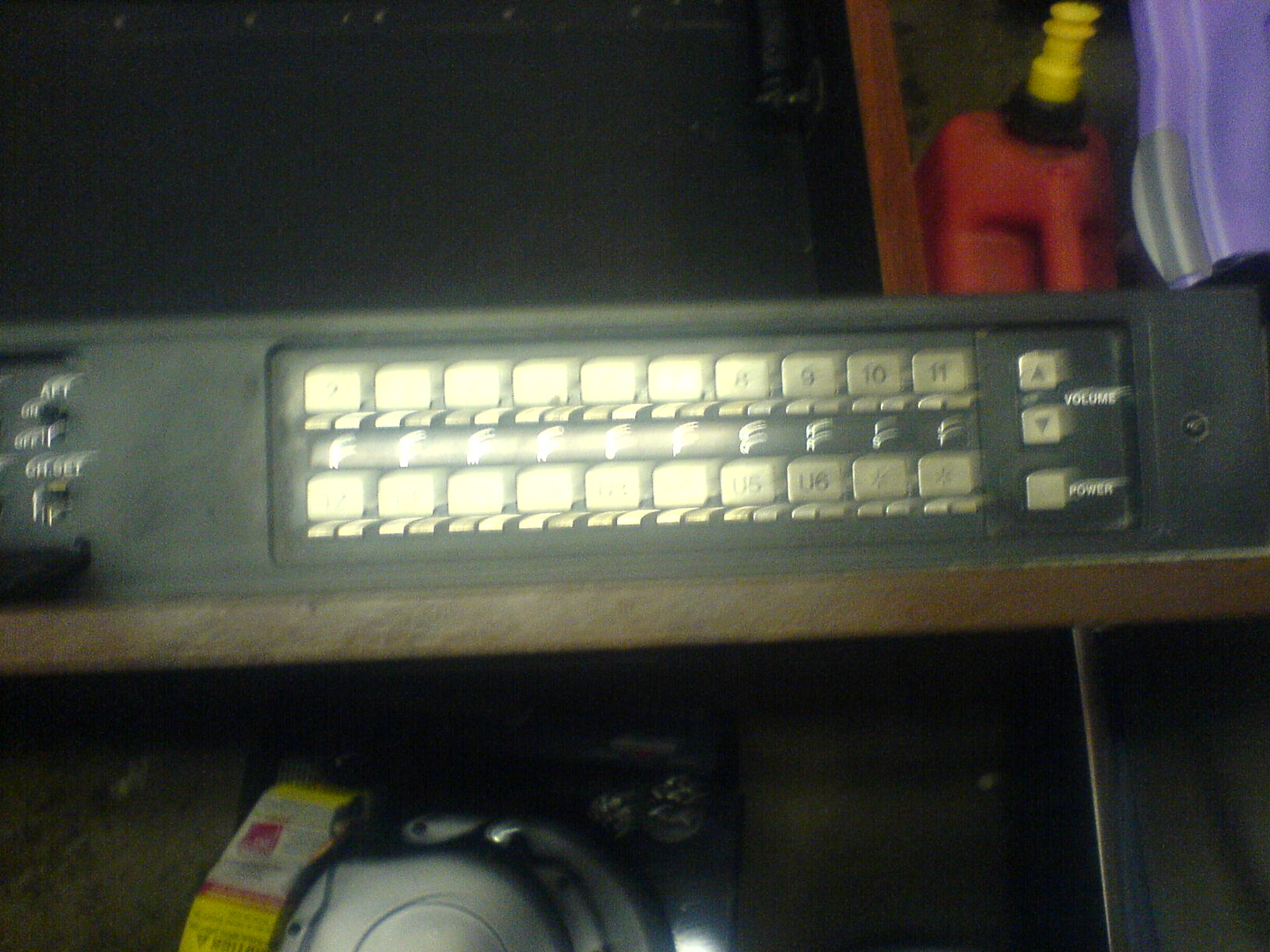

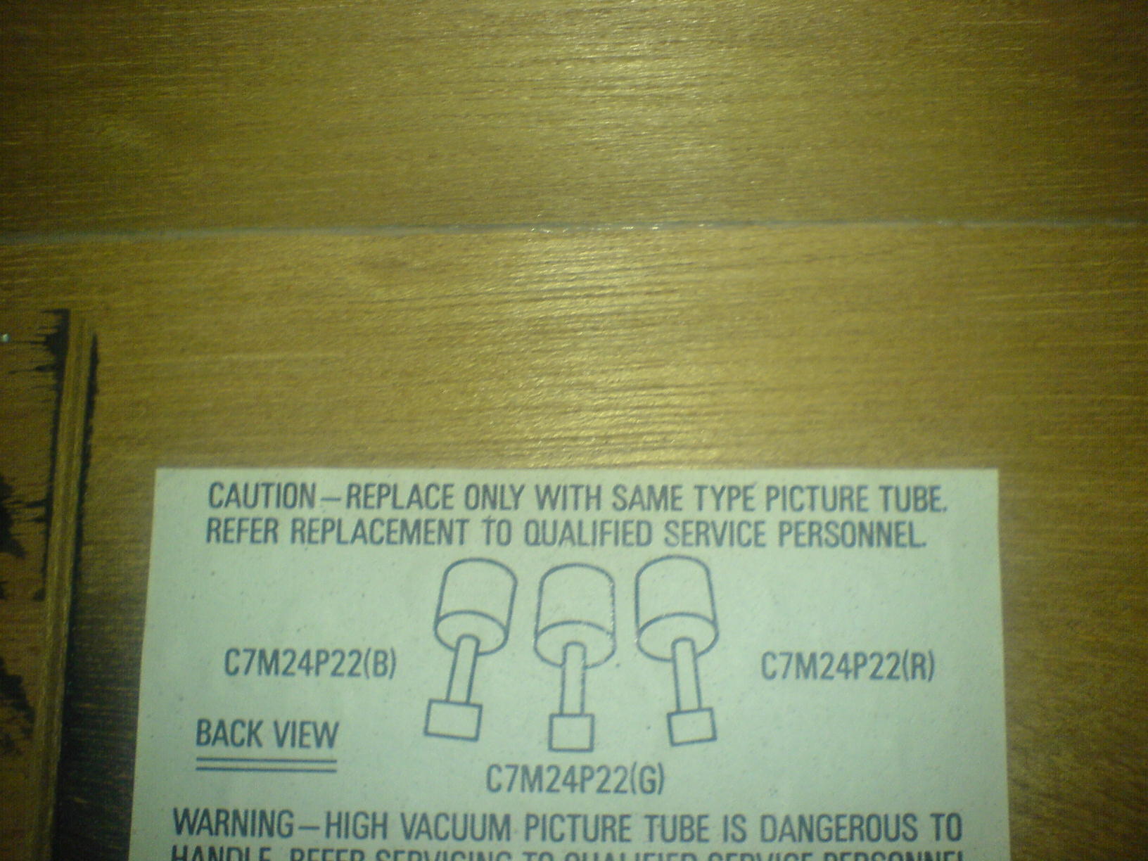

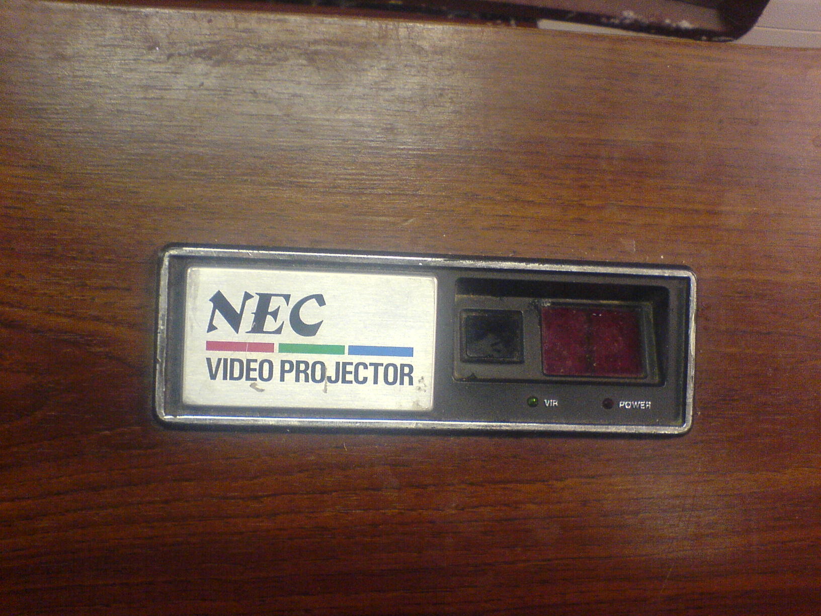

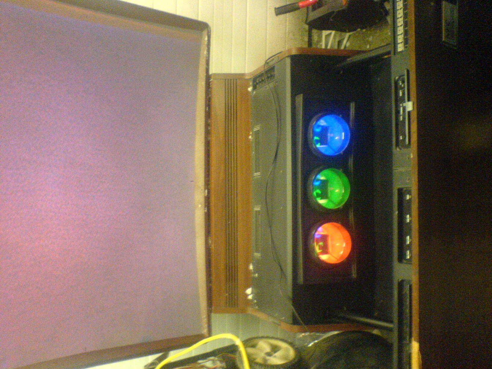

Here are some pics

Does anyone with a similiar model know how to get into any kind of setup mode?
It has a really simple test mode that brings up a single cross hair for red blue and green but that is all I have found so far.
working ECP 4100.
marquee still in pieces, just gathering knowledge.
optoma ep729
dbaisey
Posts: 821
Posted: Thu Mar 06, 2008 7:41 pm    Post subject:
This should all be mechanical via the board with the pots. If it has a test switch push it or feed a external RF test pattern to it. Doug
the_avguy
Joined: 16 Mar 2007
Posts: 91
Location: Edmonton, Alberta
Posted: Thu Mar 06, 2008 11:18 pm    Post subject:
Doh, of course I can just feed it an external signal to adjust.

I might be crazy, but those CRT's look weird. Almost round at the end.
the_avguy
Joined: 16 Mar 2007
Posts: 91
Posted: Fri Mar 07, 2008 10:02 pm    Post subject:
They do look weird and they seem to have a plate right in the middle, very strange looking.
working ECP 4100.
optoma ep729
kschmit2
Posts: 1141
Location: Heidelberg, Germany
Posted: Fri Mar 07, 2008 10:45 pm    Post subject:
they are Schmidt optics
see here for basic info:
http://en.wikipedia.org/wiki/Schmidt-Cassegrain_telescope

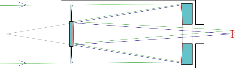

as I understand it, in a CRT PJ the tube would be the red X in this diagram:
