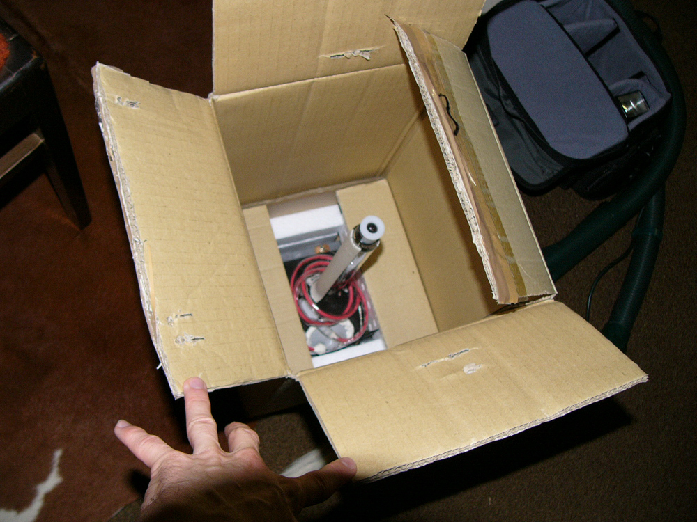

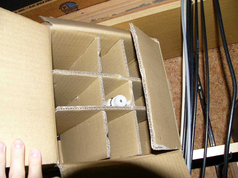

Here's a look at NEC's original packaging:
Nec Tube Packaging 01
 Filesize:  490.44 KB
 Viewed:  7049 Time(s)
Nec Tube Packaging 02
 Filesize:  479.71 KB
