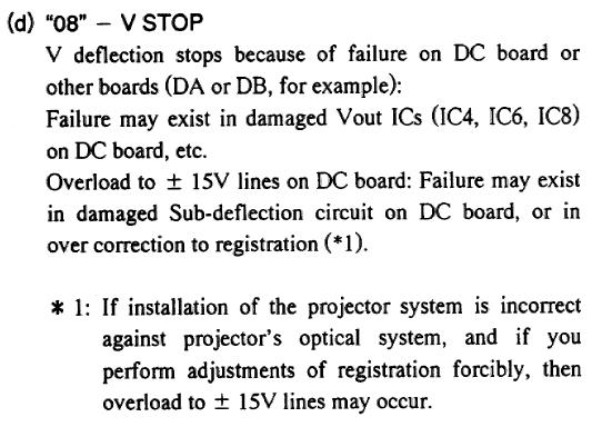

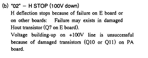

Posted: Thu Mar 06, 2008 2:13 pm    Post subject:
Error 08 is a problem with the DC board usually..
Error 02 can be on the E board, the P board, and sometimes the HV splitter between the green and blue tube necks..
Here are a couple of clips from the service manual, along with a link to the layout/downloads section on this site.. The components on the boards are marked to help you find them.
Error 08 can also be over adjustment of convergence controls, but unlikely if the set just quit while running, and not being set up.
 Filesize:  43.3 KB
 Viewed:  6526 Time(s)
 Filesize:  23.59 KB
