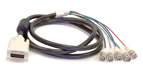

Posted: Wed Feb 27, 2008 6:01 pm    Post subject:
There's also the DVI-I to RGBHV breakout cable available for one of the banners on this site:
http://www.infinitecables.com/mon_dvi-vga.html#2
