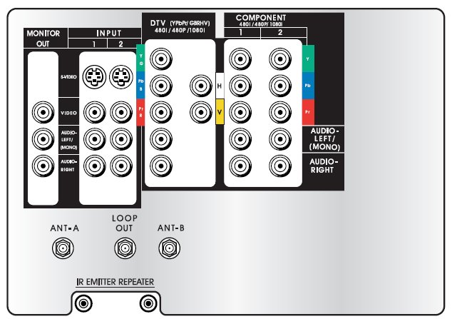

Acording to what I just found on this TV it can do 1080i!! You can run a high def signal into it and as with most Mitsubishi set's I bet it will look great!
What ATi card do you have? Most will output over the component quite well at 1080i. You may have to adjust for overscan by customizing the desktop sizing.
I see by the back pannel you have the RGBHV input option! This will allow you to run VGA directly into the set. Now the input is labeled 480i/480P/1080i so you should be able to select 1080i in your ATi drivers ( there's an option to force 1080i in the newest drivers )
and use a VGA to RGBHV break out cable, either with BNC to RCA plug adaptors or get a cable like the one below that goes VGA to 5 x RCA.
I found those for sale here: http://www.digitalconnection.com/products/cables/eehd5r.asp

My ignoramous endeavors were never successful getting Powerstrip in Windows to display anything beyond 480i/P using the DTV input on RGBhv. I have a 65907.

Yeah, me too on my circa 2000 Mits 55"HDTV.
The sounds the set made when trying to use custom timings were down right scary. You have to remember these sets are NOT multi-sync like most computer monitors & projectors that will sync on about anything you throw at them.
I don't know if you could damage them by sending a crazy timing to them, but I didn't care to find out.

You must remember when you feed it RGBHV to go to setup and change the input from Y Pb Pr to RGB. Did you read the Powerstrip set up guide by Karnis on the A site?

Of course. I had first used my Mits with the Samsung SIR-TS160 DirecTV HD STB. It worked for both Component and RGBhv on the DTV input.
