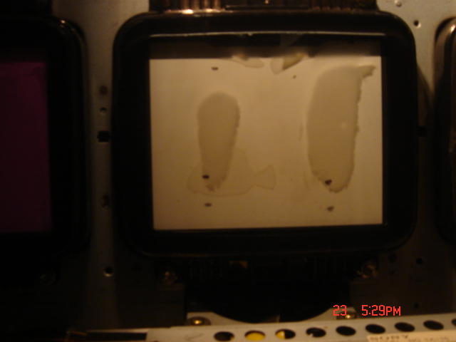

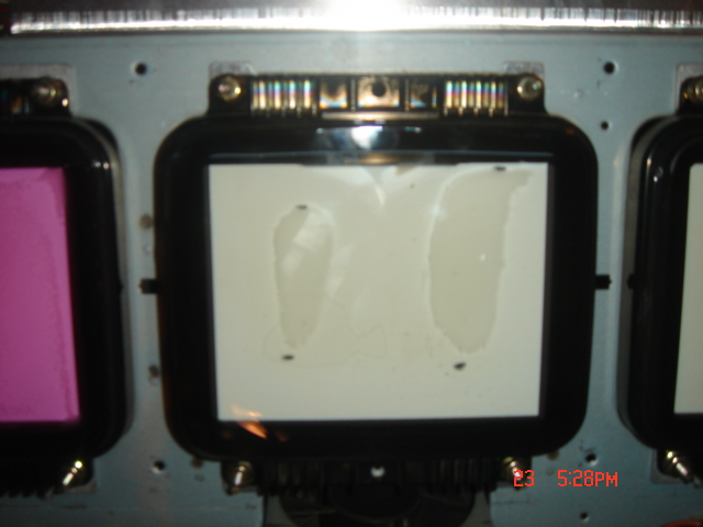

firts sorry for my inglish i am from argentina and i have problems with my sony vph1042qm, i love it!!! i clean and a encounter in the tube in the front, like a water in the glass, but i dont no what is this and produce a disfocused image, its happens in the center and the mag tube, i send you a picture, its possible to disamble and clean? the 2 points black is for mark the glass
THANKSSSSS!!!! and sorry again for my inglish! if you have a web in sapnish for this problem tell me please!

It looks like your Sony has the dreaded fungus problem, its something that grows in the glycol coolant in earlier sony tubes
Theres two ways to get rid of it, the hard way as described in the link below, which involves removing the tube, draining the glycol, cutting the front glass off and resticking it back on, i have done this procedure about 10 times and it works
http://www.eboyztoyz.net/article.php?ncat=00145#Fungus_removal
Or you can wash the tube out using CLR, you will have to do a search on this as i no nothing about it, im sure someone else will chime in
All the best
James

Tengo el mismo problema en un ECP 2100. El razon por eso es que el liquido dentro la lampara hace una reaccion con el material del cajon que retiene la superficie de vidrio. Hay dos maneras descriptadas aqui:
http://www.curtpalme.com/Fungus_Removal1.shtm
http://www.curtpalme.com/CLR_Defungus_Sony_Tubes.shtm
debes que leer estos muy cuidadoso.
Aqui una pagina en castellano:
http://www.yoreparo.com/foros/proyectores/soluciones/pantalla-de-proyeccion-liquido-de-tubo-t100050.html
No me tienes miedo de apartar la lampara! Preparate un lugar bien limpio como una mesa grande cubierto con una manta o similar, trabajo con cuidado ( te recomendo hacer unas fotografias de los detalles antes de apartar! ) y tal vez te haces noticias de cada paso.
Para rellenar la lampara, aqui esta una receta por el liquido: 70% glicol etilenico y 30% glicerina. los ambos vas a encontrar en cada farmacia y seran baratos. No se la cantidad de liquido en su lampara, solo comparala con el liquido viejo.
Entonces, buena suerte con tu trabajo y muchos saludos de Bavaria.
