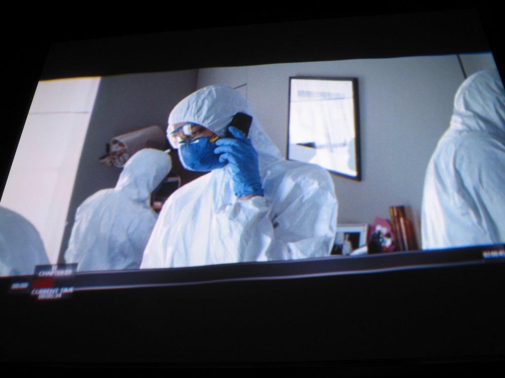

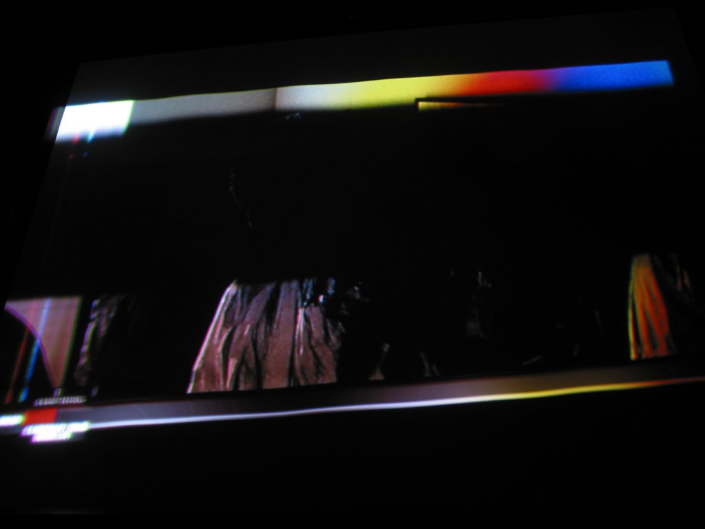

I did a parallel test from the HTPC with componet cables and HDMI into the 07 moome card. This was installed in the PC1271 and then RGBHV to the Ampro 4000. I ran it at 1080i and did the A/D comparison.
Analog looked great! HDMI well it reminded me of the old macrovision days with a really badly encoded tape. The picture was unwatchable. See the 2 pic's below.
1080i over HDMI to 07 HDMI Moome card in PC 1271 switcher
 Filesize:  40.95 KB
 Viewed:  5107 Time(s)
1080i over componet to 07 HDMI Moome card in PC 1271 switcher
 Filesize:  67.1 KB
 Viewed:  5108 Time(s)
