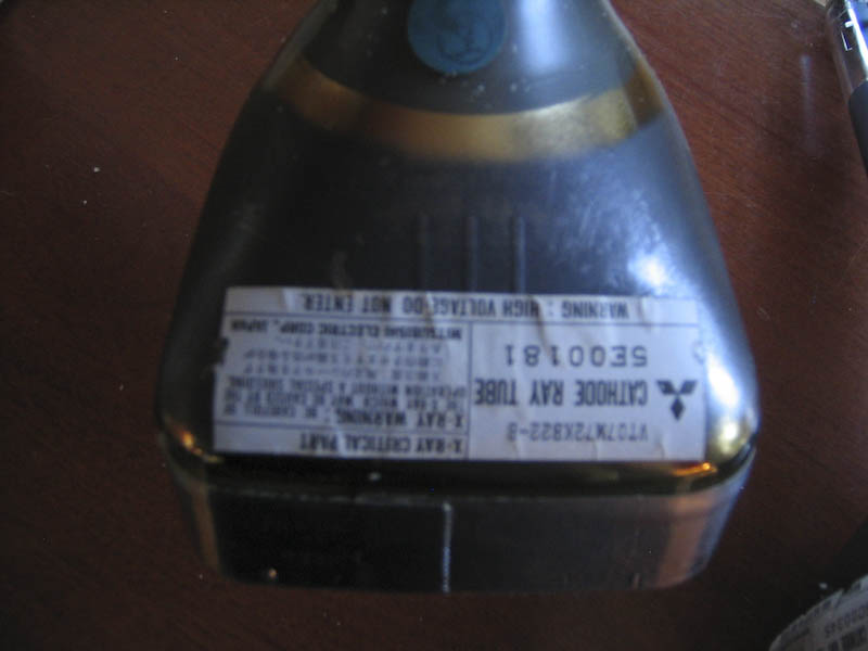

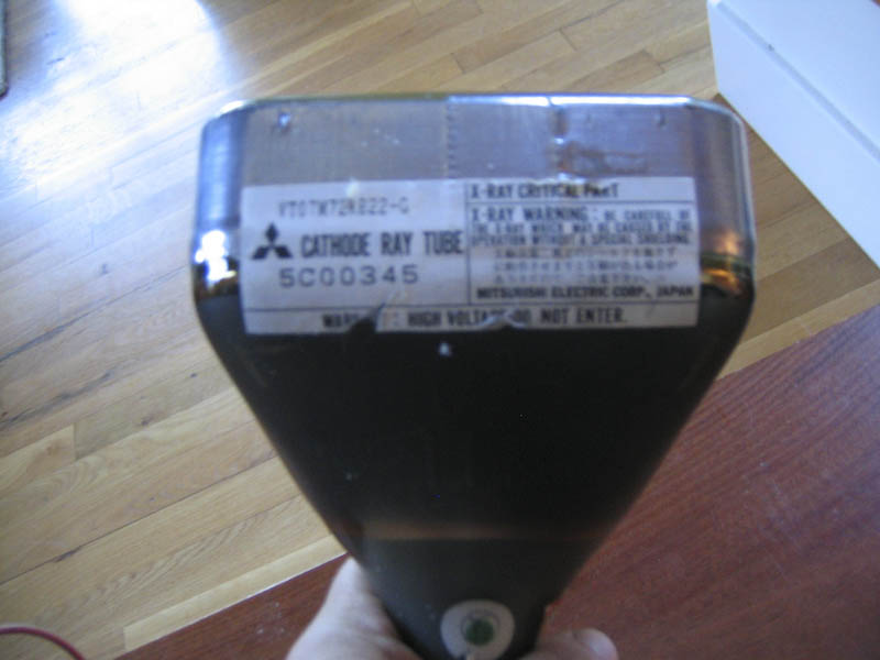

Posted: Thu Feb 21, 2008 8:59 pm    Post subject: Here are some pictures
I had taken these but didn't post them because they are a bit blurry. Is there a part of the tube other then the label that would be informative? Thanks for your help...
1st tube

Posted: Thu Feb 21, 2008 9:38 pm    Post subject:
What size tube is it?

Posted: Thu Feb 21, 2008 9:43 pm    Post subject:
my guess: a 45" Mitsubishi rear projection tv.....

Posted: Sun Feb 24, 2008 9:13 am    Post subject:
The deflection angle is all wrong too.
It's totally different to a G70 tube.
It's not a NEC tube, either. Both are PANASONIC tubes, not Mitsubishi.
You got ripped. But you also should have done some basic research...sorry, but you know the saying..."buyer beware"..
