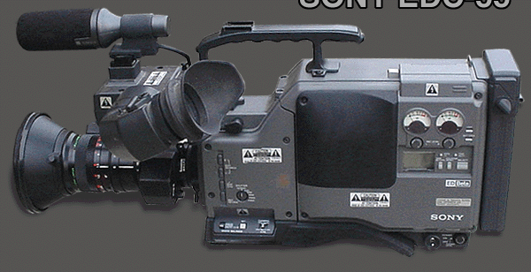

Posted: Thu Feb 14, 2008 6:25 am    Post subject:
I've turned my B&W viewfinder on my Sony EDC-55 EDBeta camera into a wee 6" projection to show people what I just shot. I used a pocket fresnel lens and a white wall. The eyecup swings aside and I just held the lens infront of the viewfinder.
That was lighter than toting around the 5" CRT TV.
 Filesize:  106.91 KB
 Viewed:  11510 Time(s)
