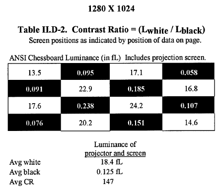

Great document.
I've seen Ken do these measurements and the results are always interesting.
But it's hard to put any of the test measurements into perspective unless you compare them to something else... e.g. before and after calibration or compared to another projector.
Notice how the black squares measure worse in correlation with the number of surrounding white squares. Logical.
I'll have to read to see if the room had dark walls. Looks like there might've been a lot of reflected light off that 1.3 gain screen ruining the black levels.

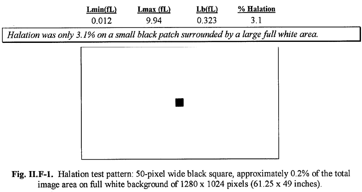

Interesting... I would've measured the halo in the opposite manner. I always think of the green square generated by the ACON. On a air-coupled 8000/8111/8501, the green ACON square clearly creates a soft halo. But on the 9501LC, the halo around the ACON square is much improved.
But maybe it's more complicated to measure on the outside of a square, because then you'd have to decribe parameters for halo effect from a given distance from the lit square.

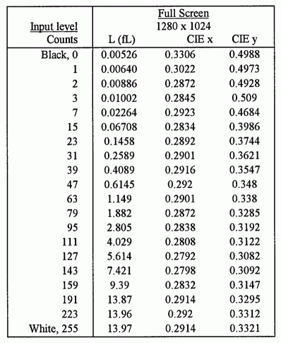

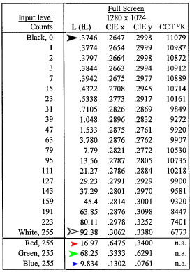

Those extra lumens at the high-IRE offset the poorer black levels...
black gives 0.37FL from the lightvalve Shocked
black=0.005 from the M9501.
Check out how much light output comes from green...

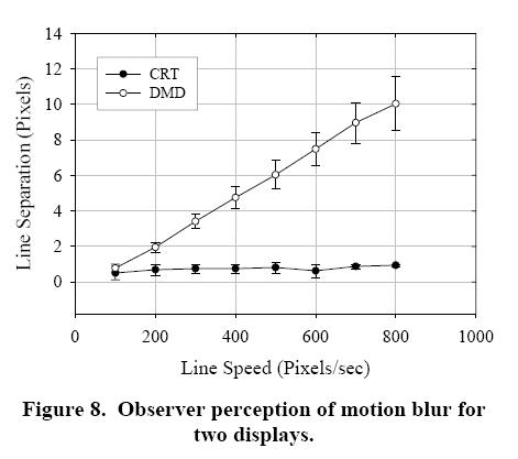

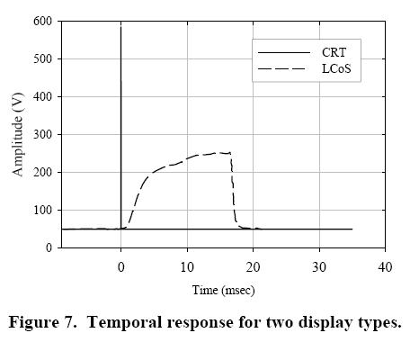

Sweet - now we know why CRT ROCKS for smooth, natural looking motion!!

I just noticed that 0 IRE ("black") from the lightvalve (0.3746FL) is brighter than everything below ~35 IRE from the M9501. Shocked Mr. Green
