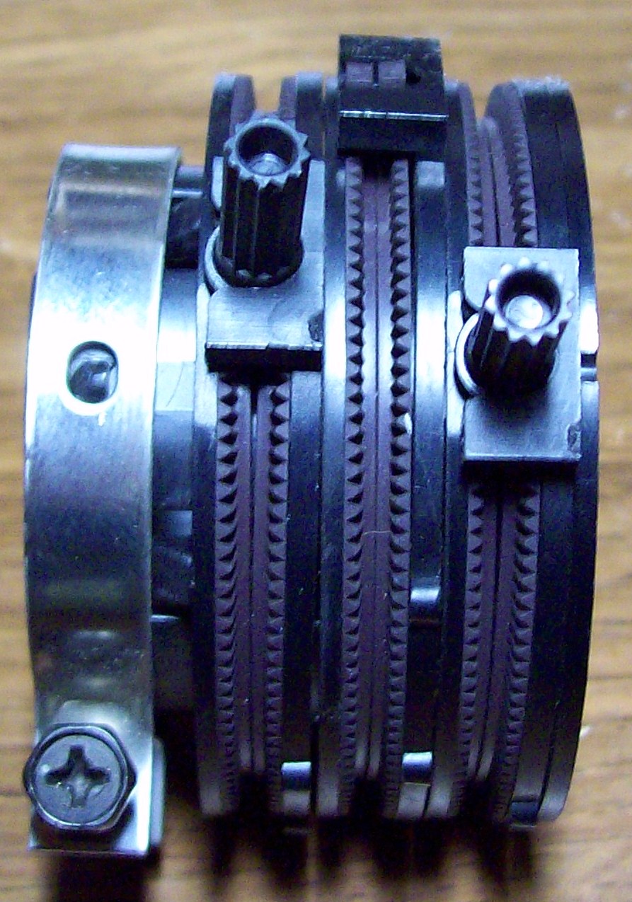

I am curious is this a 2/4 pole cpc? and if so i read somewhere that you could make it a six pole with magnets. I just don't remember where i saw it. thanks for the help

??? Did you attach a pic

I read that too.
you have to use some small rare earth magnets and arrange them on the ring material and let them sit overnight.
some CPC rings are un-magnetized. I have a couple sets that have 2 pole and 4 pole and a third set that are not magnetized at all. Its only that third set that you can do that with unless you have a way to "erase" the 2 or 4 pole version.

yes i did attach a pic I will reattach the pic again I am curious what rings are what

do the rings need to be in a specific order 2/4/6 2/6/4 etc?

those are 2/-/4
there is no 6

would the six go in the middle does it matter where the 6 pole is in the config?

i don't think it matters

cool I will try and magnetize the center rings to be six pole Just for giggles i will make the 6 pole rings closest to the front of the tube.
Do you know which is which 2 / 4 they have white on the tabs and yellow.
I cant remember white is 2 pole and yellow is 4 pole ???
Does that sound correct?

the front ones are 2 and the rear ones are 4 IIRC.

lay one flat , put a piece of paper over it and shake some iron filings on the paper. it should show the magnetic pattern.

Any luck manually magnetizing the dead ring? I have a set I can pull from a 1208/2 that look just like that pictured, AND I have access to LOTS of ridiculously powerful rare earth magnets. (Not to mention several 800+ Joule magnetizing machines Wink )
Posted: Sun Sep 21, 2008 5:31 pm    Post subject:
Wait you have acces to a magnetizing machine?!!!! We might be able to remagnatize regualr barco focus magnets and the do a rewind to the marquee specs and crank out some franken yokes !!!!!
