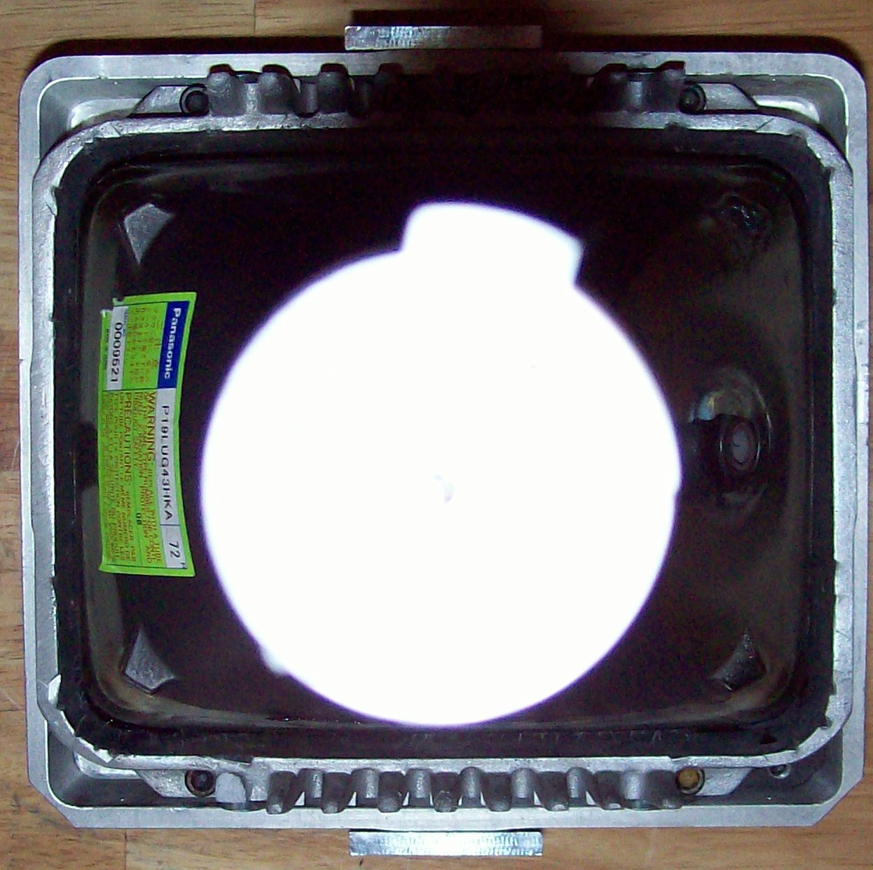

the first pic is the red you can see how the casting is fubared. only the heatsink part and not the whole thing as the pins and such line up just fine. and are properly square. I squared the tube to the projector flange and siliconed it in not even noticing the fact that it was disfigured.
here is the green for reference
 Filesize:  330.89 KB
 Viewed:  3242 Time(s)

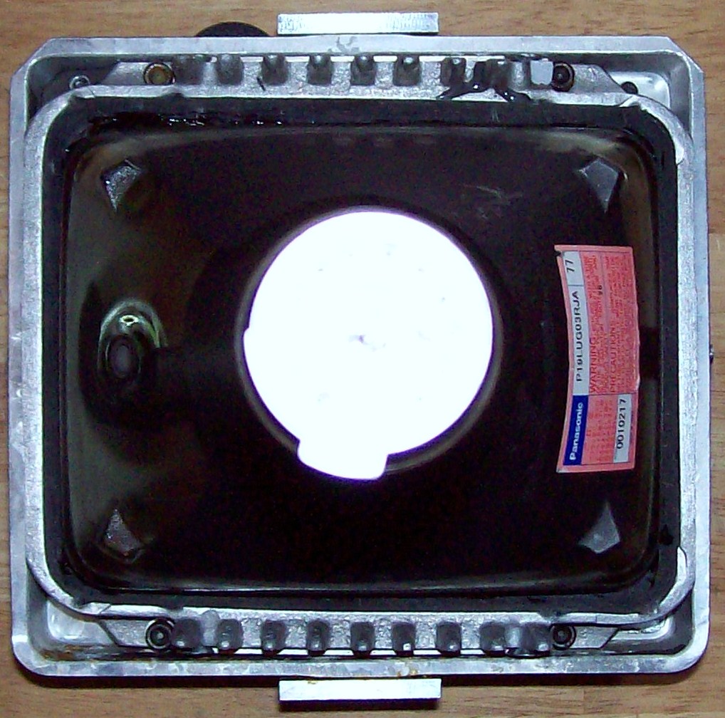

Here is the red that is poorly cast
and cocked.
 Filesize:  278.94 KB
 Viewed:  4321 Time(s)

Posted: Sat Feb 02, 2008 12:19 am    Post subject:
Hello
Is there a pivot pin installed both sides? The one visible does not look like it is crimped in properly.

Posted: Sat Feb 02, 2008 1:11 am    Post subject:
yes the pins are installed I just have not pinned them in yet I had them out to expand the chamber so i clean all of the junk off of the bellows. I just have not fully reinstalled them.
Isn't that wierd how off the casting is
