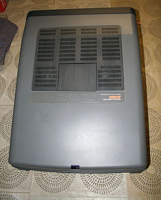

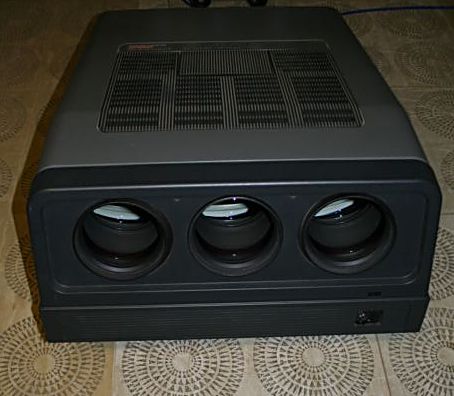

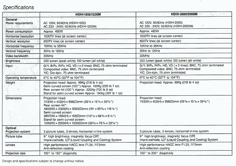

Posted: Wed Jan 30, 2008 8:38 am    Post subject:
It's not worth more than maybe 500 Euros IF it is in perfect working condition.
It pre-dates the 1292 (released in 1989). So it is 19 years old.
In stock form it does max 1080i60 (max scanrate of 35 kHz, max Bandwidth of 30 MHz). Spatztech from Germany had a modified set that scanned to something like 90 kHz though, but that was maybe a one of a kind deal.
Kai

Neat! That's the 1270 on steroids. Too bad about the bandwidth though.
Posted: Wed Jan 30, 2008 5:40 pm    Post subject:
I don't think the bandwidth limitation is really a big deal to make it a nice 1080i machine. In fact, that machine was designed specifically FOR 1080i. Actually, it wasn't 1080i back then - it was called 1125-line HDTV back then, which was essentially the analog predecessor to the 1080i we use today.
1080i really only needs about 35mhz of bandwidth in the display, and 30 isn't far off. There'd be a little high-frequency roll-off - which is probably where the 1000 TV lines spec comes from. But, my 1271 and 1272 are rated 75 and 85 mhz respectively, and they don't even come close to fully resolving 1920 or 1080i. The additional bandwidth in the 1271 and 1272 was so it could half-acceptably display 1600x1200@60hz, which requires about 2.5x the bandwidth as 1080i!!!
Also, I know the lenses are definitely a shortcoming in both of my machines. I bet with those Nikon lenses, it would be every bit as nice looking as any other 12xx - if not better.

I know - I was thinking the same thing. It looks like a really sweet screen. Did you see the size of that thing? 112.5" x 66.75" - about 9 1/2 x 5 1/2 FEET! That's bigger than my WilsonArt screen - which seems HUGE to transport. Can you imagine shipping that thing!!?!?!
