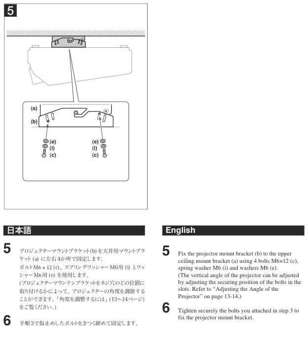

Does anyone know what size screw is used to hold the angle on a PSS-70 mount?

Pretty sure they were metric 10mm...fine thread...I think I've got some extras lying around...I'll put them on a thread gauge in a couple hours when I get back

Looks like M6x12.
