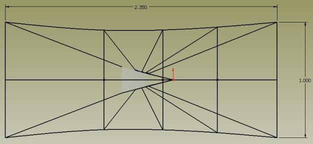

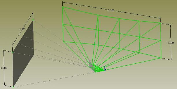

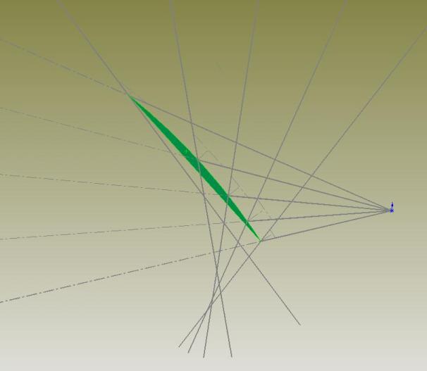

Posted: Fri Feb 08, 2008 1:58 am    Post subject:
You can get the image close to the correct shape with simple mirror. It would have to be rescaled though to correct the nonuniform horizontal stretch. I'm sure the projector could handle the pincushion.
I think the problem is that the reflected lines don't converge to a focal point behind the mirror. I don't know much beyond that though.

Posted: Fri Feb 08, 2008 3:52 am    Post subject:
Nice drawings, but now make that work for 3-lens projection with three different projection angles (offset and toe-in)! How large would the mirror have to be? Finally, as you indicated, the focal plane is not a plane anymore, but a warped plane (rectangular section of a cylinder). You'd be able to properly focus the edges but not the center, or the center but not the edges. If you think about it, your drawing actually illustrates the complexity of the problem and why it won't work for a CRT projector.
