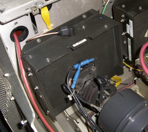

Posted: Sat Jan 26, 2008 5:56 pm    Post subject:
Thanks for the extremly fast reply.
I am not experienced with the hardware. Are the neck boards in a box? To to be sure to swap the right thing I made a photo (attached).
Neck Board?
 Filesize:  86.1 KB
 Viewed:  3389 Time(s)
n@t
Joined: 02 Apr 2006
Posts: 63
Posted: Sat Jan 26, 2008 6:26 pm    Post subject:
Yes Very Happy

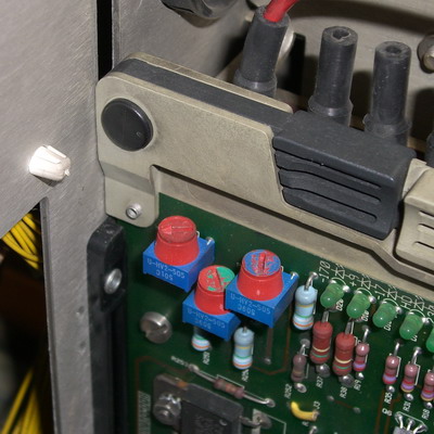

I do not see any improvement yet, blue is weak also in the lower IREs now. In a black picture I can not see any raster glowing on the blue CRT. Phosphor is completely dark. So I guess I need to re-adjust some things, at least G2.
It is years ago since I have set up the projector and did not touch it since then - so I am not 100% sure anymore where to adjust G2 (my 1208 does not have G2 setting in the OSD menu).
Are the potentiometers in the picture the ones to control G2?
G2?
 Filesize:  60.61 KB
 Viewed:  3338 Time(s)
n@t
Joined: 02 Apr 2006
Posts: 63
Posted: Sun Jan 27, 2008 12:56 pm    Post subject:
yes the Potentiometers ones to control G2!

Elmar
Joined: 26 Jan 2008
Posts: 11
Location: Munich, Germany
Posted: Sun Jan 27, 2008 4:17 pm    Post subject:
Thanks. In the meantime I re-adjusted G2 and the color balance quick&dirty, I am pretty satisfied with the result.
Just one thing confuses me: If the problem is the neck board, I expected a similair problem as stated in my first posting with green instead of blue after the swap -> I expected bright white szenes to have a magenta colour fault. This did not happen. Maybe the new G2 settings supress the effect.
However, my problem is solved now, thanks Curt, thanks Bernd.
