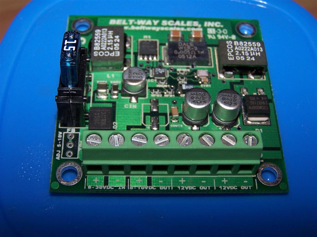

If you want to regulate 24 to 12, I would use a switching regulator if anything, they are more efficient then a liner one. I have a switching regulator that I designed, on a PCB and all. It will allow 6-30 VDC input and has dual outputs @ 12 VDC. Max draw is around 1 amp. It is fuse protected as well.
I will if I can get some pics of it, probably a better solution for this type of fan mod.

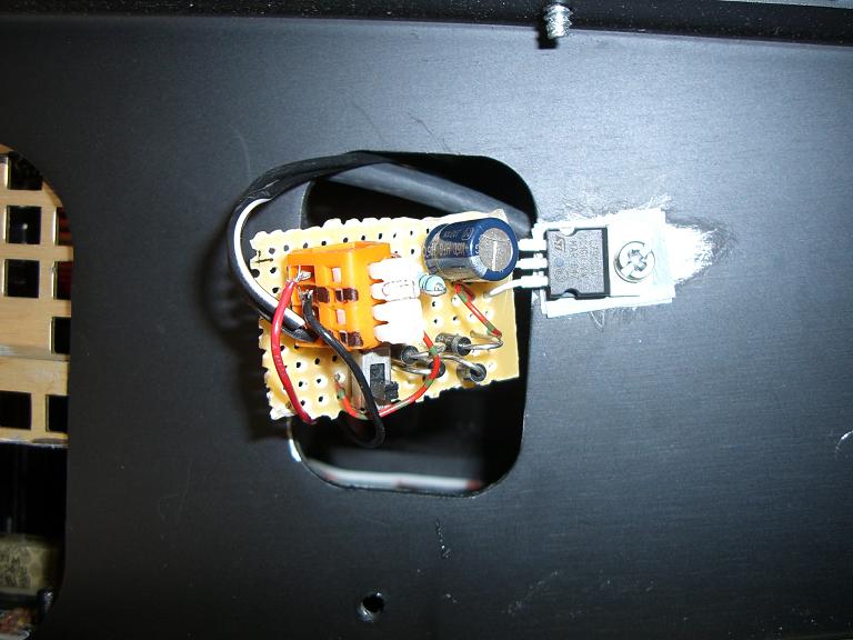

About that two 12v fan in series i must say that when i changet lvps fans (new silenx models->older 120mm models ) i tested that what happens if one fan stops. I stopped other fan and voltage across other didnt raised much (volt or something..) so i connected those series.. Maybe other fans behave different.
Here is how i dropped that -24 volt to lower for tree belly fans
I used 1ohm fusible resistor then 100uF cap and 7915reg. that gives -15 volt, after that there is four 1n4007 diodes series and little two position switch witch selects voltage after two diodes or after four diodes (about -12 & -13,5v)
So i got "summer" position, if room temperature is hot i can run those belly fans little higher voltage.
Actually i got four 12v papst here.. only tree is in marquee, one is waiting that i got inspiration to get marquee down and modify that fan tray for four fans..Btw its really PITA change those fans when projector is ceiling mounted.
Btw. Mine lvps is 10-000-229-02p iss.1

voodoo7869
Joined: 19 Oct 2007
Posts: 193
Location: Chicago, IL USA
Posted: Sat Jan 26, 2008 8:16 pm    Post subject:
now that is a nifty mod looks like fun. looks like you even buffered the voltage very cool

fireanimal
Joined: 17 Jul 2007
Posts: 231
Location: Stayner, ON
Posted: Sun Jan 27, 2008 4:22 am    Post subject:
Here is a pic of the swithing reg. that I was talking about.
 Filesize:  97.22 KB
 Viewed:  9144 Time(s)
Joust
Joined: 05 May 2006
Posts: 2429
TV/Projector: Marquee 8501LC
Posted: Sun Jan 27, 2008 4:37 am    Post subject:
Nice little module. what do they go for? I could use a few for various projects.
fireanimal
Joined: 17 Jul 2007
Posts: 231
Posted: Sun Jan 27, 2008 5:13 am    Post subject:
They are small footprint as well aprox. 2"x2". Probably be around $50 each, which is way less than usual price.

fireanimal
Joined: 17 Jul 2007
Posts: 231
Posted: Sun Jan 27, 2008 5:25 am    Post subject:
Propritary, designed by myself.
Gino
Joined: 22 Apr 2006
Posts: 1363
Posted: Mon Jan 28, 2008 2:09 am    Post subject:
are you able to design one for use for the belly fans so that i can use 4 x 12v fans there? i'd buy 2 of those from you and also 2 of the other one you designed for the lvps Smile
fireanimal
Joined: 17 Jul 2007
Posts: 231
Posted: Mon Jan 28, 2008 2:23 am    Post subject:
If I do some testing to ensure the amperage load, the current design will work for 4 fans. The circuit can currently work with up to 2 amp draw with no cooling. Any more than that there would have to be heatsinks installed on some of the components. If you were to tell them amperage rating of the fans that you intend on using that would help.
I belive though that most fans to not draw that much wattage.
