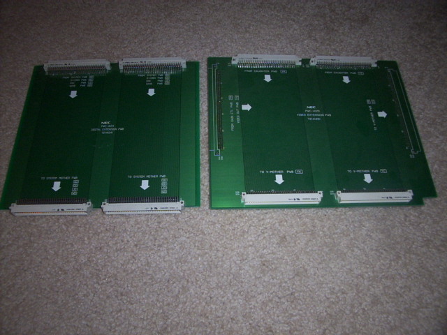

What I need is the NEC extender boards (nudge nudge, wink, wink)

If anyone can mfg a duplicate set PM me.
 Filesize:  94.9 KB
 Viewed:  10118 Time(s)
Posted: Thu Jan 24, 2008 3:45 pm    Post subject:
DAMN those are PRETTY!

I have some ideas about this. Pretty good with this type of logic, and talked to Doug about it many times. But without and extender card, we'll never know.
Marc
This space for rent.
