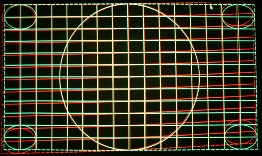

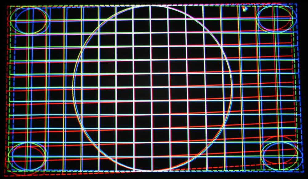

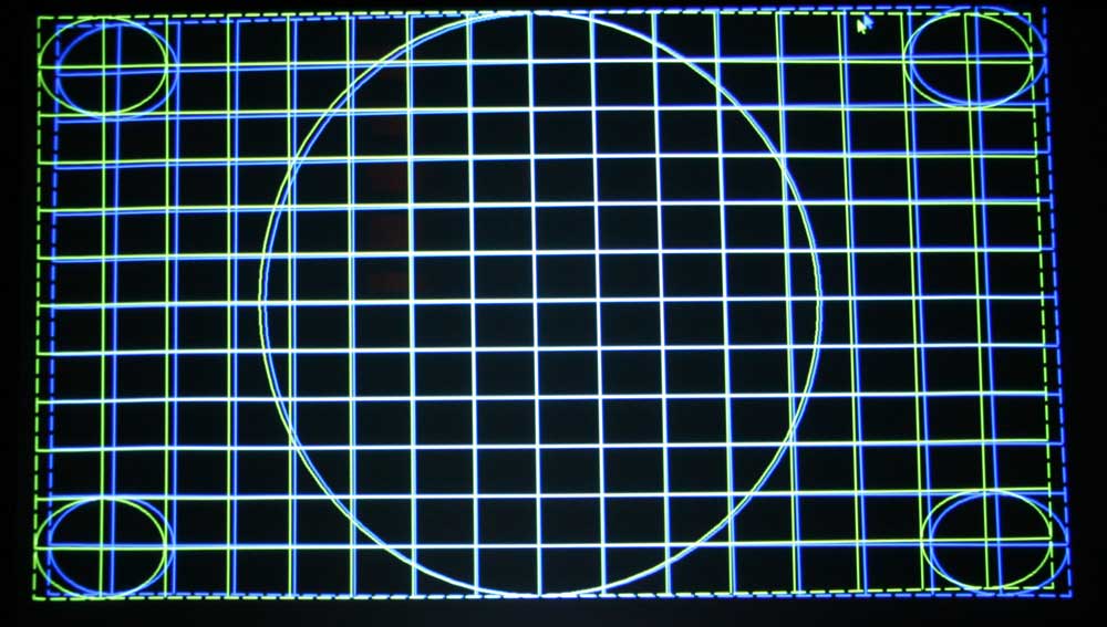

I have some troubles with my BARCO Graphics 808 with linearity and geometry as shown in the pictures below.

(Pictures with 720P without convergenz only geometry on Green, before I delete all Block and set to midpoint)

Red and Green

Blue and Green

all 3 Tubes

Did you rotate the yoke to level the picture on all three tubes while keeping top-bottom centerline skew adjustment on Green at 49. Your goal is to level the horzontal centerline.
There is no individual linearity adjustment for Red and Blue. Left and right sides of blue and red should be corrected using convergence. Notice the overlap in adjustment between the convergence positions (Convergence position selection square)
Posted: Wed Jan 23, 2008 1:57 pm    Post subject:
That all looks normal to me. As r. bauer says, rotate the red yoke slightly to even out the mismatch on the V plane, but you'll add some to the H plane. THe convergence controls should correct everything out.
Person99
Posts: 4899
Location: Flower Mound, TX
Posted: Wed Jan 23, 2008 3:08 pm    Post subject:
I'll third that! Smile I'd get the red evened out and you are there. This is normal.
