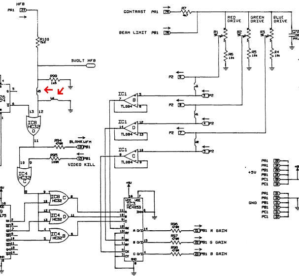

As for the retrace issue, the described mod only affects the G1 voltage and I don't see how it can effect the contrast circuitry. G1 is slow to come back so the raster gets darkened on the edge. This should be well out of the image area anyway. There are other ways to fix the issue, but none as simple as this, with the only problem being a slight loss of available raster (which shouldn't be used anyway).

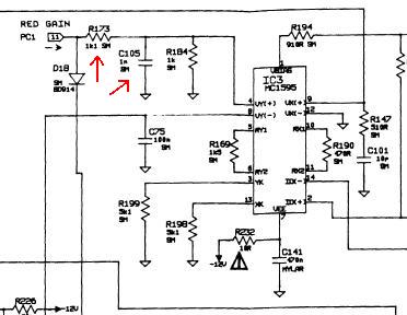

Regarding retrace issue: I have extensively tested this mod. To see the difference between unmodded and modified versions instead of moving the jumper I installed a switch with one position as unmodified state and another as modified (equivalent of moving the jumper). This allowed me to see the difference between two states without removing eyes from the screen while the projector was operational. I displayed gray field and was disappointed to see a lot of lost detail in modded version while switching fast between the two positions. Later scope observations taken at the neck board also confirmed this. Waveform taken at the neck board of a single scan line with the gray field displayed resembled a waveform of capacitor charging, it is rises very fast at first, then flattens but still keeps to rise and takes very long time to reach its maximum level. In higher refresh rates the darkening of the picture (or rising of the signal) continued well beyond center of the screen. It is not easy to see without directly comparing it to unmodded version because the change is gradual and very smooth.
I will explain how it also affects contrast circuit. As can be seen on the schematic of Waveform module below, the mod requires to move the jumper from W4 position to W5 as marked by red arrows, this allowed modified BLANK WFM signal to go to BIAS module and to G1 circuit. No problem here except that G1 is slow. What was overlooked is that the same signal also went through series of OR gates to IC3 where it mixed with Contrast signal for each color. At the output of IC3 contrast signal (gain) began to fall to zero for each horizontal retrace. Then new and modified contrast signal went to Video Control module (second picture), where before entering IC3 in case of red color (other colors similar) it went through network of R173 and C105, which form a low pass filter. Now imagine changing the state of contrast signal for every scan line, the result I described above.
I am convinced that this was the reason why E-home decided not to do the mod and actually removed the jumper option in later boards.

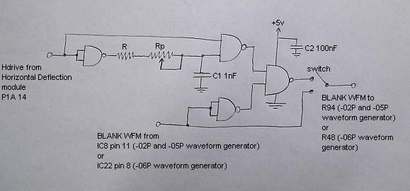

First picture shows the theoretical circuit. Hdrive signal enters the circuit and becomes converted to pulse with adjustable duration, then it combines with original Blank Waveform signal in OR gate and goes to BIAS module. Potentiometer changes the duration of the pulse and allows precisely adjust the point at which to start to rise G1 voltage. Switch is used to choose between modded and unmodified versions. It is not really needed, but I find it to be very useful to see the difference the mod does and it also allows returning the board to original unmodded condition without soldering. Instead of using 5volt Horizontal Flyback signal as it was in “jumper mod” I used Hdrive (Horizontal Drive). Since Hdrive precedes HFB it allowed to cutoff G1 before the scanline is finished and eliminated unwanted vertical bright line at the far right side of the raster. Hdrive is not present by default in Waveform module and it will be necessary to add a wire that goes to Horizontal Deflection module where Hdrive is available.
Contrast circuitry remains completely untouched by this mod and works exactly as it was designed by E-home.
The circuit in the first picture is easy to understand but not practical to build: It uses three different gates, which will require three separate chips. Second picture shows the actual circuit. It functions exactly as the circuit in first picture but implemented with four NAND gates, which will require only one “Quad 2-Input NAND Gate” chip and several other components.
I tested the circuit on ECP 3000 (50-1873-02P Waveform module with 4011 chip) and on ECP 4000 (50-1873-06P Waveform module with 74LS132 chip).
4011 is CMOS Quad 2-Input NAND Gate and works perfectly for ECP 3000 but may prove to be a little slow for ECP 4xxx. I don’t remember if I verified it with ECP 4000 as it was a couple of years ago when I was playing with it.
For ECP 4000 I used 74LS132 (this is what I had available at the time), which is fast TTL family Quad 2-Input NAND Gate but it is not perfectly compatible with ECP circuitry and may be unstable. Although it works well on my ECP 4000 I would not recommend using it.
I was thinking that the best type to use would be from 74HC family (74HC00). It is a high-speed CMOS device and will be perfectly compatible with ECP circuitry as it is exactly from the same series of chips that Electrohome used throughout the set.
The value of potentiometer depends on model of the projector and on what chip is used. I settled for 10 kOhm for ECP 3000 and 2 or 3 kOhm for ECP 4000. If there is not enough range then the value needs to be increased, if the pot is too sensitive then it needs to be decreased accordingly.
Resistor R prevents NAND gate from overloading by capacitor when the pot is in its lowest position (when it virtually disappears from the circuit). Although I have not installed this resistor it is better to do it to be safe. I guess the value should to be in a range of about 200-300 ohm.

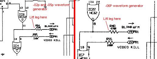

It is necessary to lift the leg of resistor R94 (or R48 for -06p board) as shown in the last picture and solder the output of the circuit to the lifted leg.
If jumper (or trace for –06p board) was moved by previous “jumper mod” it needs to be returned to its original location.
Now it is possible to center the raster on the tube face and the image within the raster as its supposed to be.
As I explained in my previous post it might be necessary to readjust the pot when switching between the bands or it is possible to set the pot somewhere in between as a compromise. I don’t see any difficulty to make it work for both bands independently, by installing two identical circuits, one for low band and another for high, and then an automatic switch that will choose one of the circuits for appropriate band, but this will complicate the design and increase the number of components (may as well be enough to get an engineering degree).
If necessary I can post pictures of finished boards, since I already by pure coincidence (Inno!) Smile have them on my computer.
Michael.
