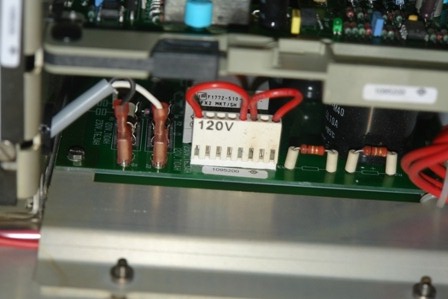

hello to all. I write you from Italy. I have a problem with my barco. I bought a projector from Usa, and I have noticed that the power plug is different from the pictures showed on Curt web site at the page 6-2 of instalation manual. Is there anybody can say me how adapt the wired plug to convert it to 230V? Attached a pic of the power plug. Thanks Massimo

Pssst! Pull that plug out, and look on the other side. Plug it back in.

Oh my God, It's so easy. Many thanks for suggestion. Massimo
Posted: Thu Jan 17, 2008 3:41 pm    Post subject:
Make sure the 220 volt side is facing up..Smile

It's work!!!! Thumbs Up
Now the baby smile. thanks a lot. Massimo
