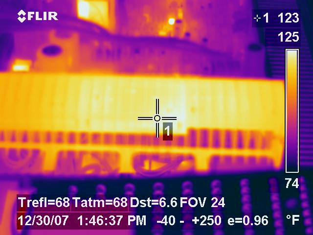

Here is an image of my PG10 after 2 hours running. Note the heatsink temperature. 123 degrees.

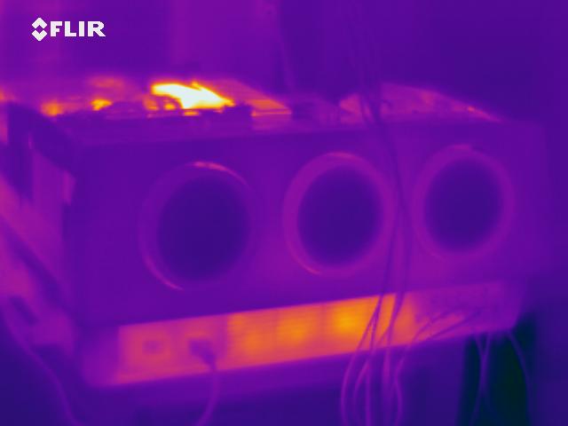

Another ghostly shot. It's projecting, but the FLIR camera does not register visible light. Makes screenshots a bit of a challenge. Very Happy

Wait....I think I see a cold air thermal in the room Shocked But I don't see a warm air thermal coming up from the power supply Mr. Green ...........

You know what? I also don't see a hot thermal distortion rising up off that heatsink.... Hmmmmmm.........

so you're saying it runs hot?? Or what are you saying here??
Can this not be modded to run a little cooler?
What res are you running through it?

THAT is a pic of a PG running very, very cool. Properly set up, with minimal electronic correction. THAT'S how it SHOULD be, but many overdrive their PG's resulting in temps over 200 degrees, burning out the H-out transistor. In real life, that heatsink is just warm to the touch. I run, and will CONTINUE to run 1080i. There is no reason to push 20 year old electronics for little gain in perceived image quality. The PG just cruises through a movie.

What is it that regular PG owners do to get their temps so high? Is it just a matter of scanrates or what?
Also, would 1080i be better on a 10PG vs an XGLC? I would really expect them to be the same as the XGLC if phenomenal at that res...
I had a PGXgtra that would only ever get to around 120 degrees max...must be because I only ever ran 1080i.

But what is it that raises the temps of the projector? Is it purely scan rate or are there other factors?

Scan rates and also poor setup. The projector needs to be set up mechanically as perfect as possible. This reduces the amount of electrical correction needed. Less correction = less energy = less heat. Poor setup is the biggest cause of failure, however.
