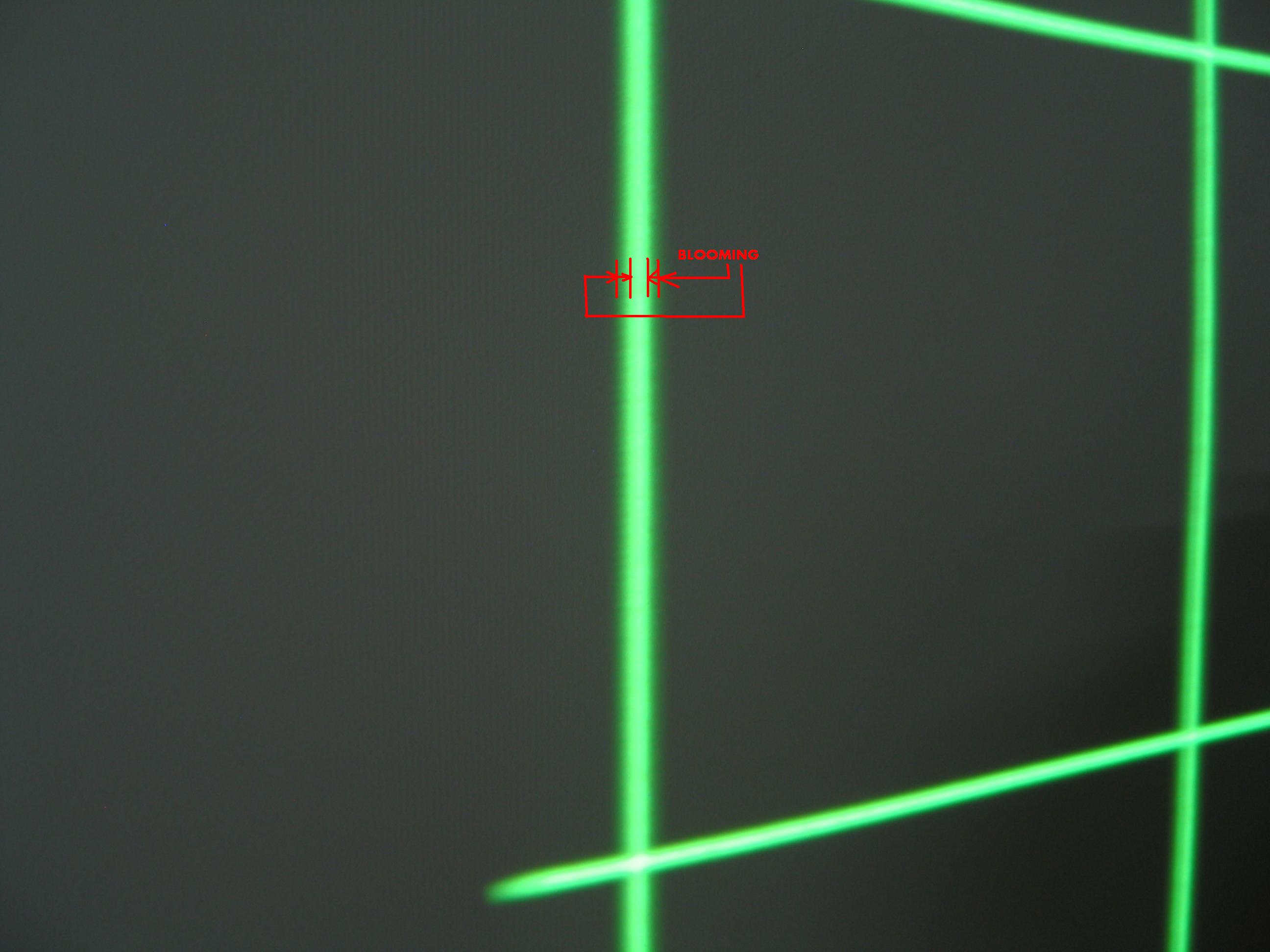

When I am projecting a thin line, the green tube only is "blooming" to the sides (<-I->) but it's razor sharp with no blooming effect on the top/bottom of the line.
I am attaching a picture to describe the problem.
The resolution of the screen is 1920 * 1080.
The green grid was taken from the "Nokia monitor tester"
Tried to adjust with the optical, electronic focusing & Astig, but this is the max. that I achieved.
Can that "blooming" problem being solved? Maybe a neck board mod.

Posted: Sat Jan 12, 2008 5:42 pm    Post subject:
Are you sure it isn't optical focus?
- 1) If you have a drop down screen, move the side/corner of the screen closer to or further away from the projector to see if the optical focus improves.
- 2) This is also a good method (moving screen away/closer or moving a piece of paper in front of the screen away/closer to projector) to check for proper scheimpflug adjustment.
Are you sure it isn't astig?
- 1) Is the mechanical astig set properly? This should be done before dynamic astig. Before doing this, set Dyn. Astig manually at 49 for all 3 colors in all 8 positions.
- 2) Dynamic astig can only be set properly when optimal optical (center)focus is achieved.
- 3) Set dynamic astig using small dots (NEC pattern generator), contrast at 99 and overfocus (= focus +20). Goal is to achive round dots. Sometimes a little more or less overfocus is required to clearly outline the distortion in the dots that need to be corrected. This depens on each individual tube.
Too much overfocus makes adjustment impossible as the dots all become blobs with no contour.
After these two adjustments, check your EM-focus again.
Is the focus coil properly positioned along the tube neck?
- 1) Set focus at 50 (Barco suggests focus at 57), loosen the focus coil in front and in the back, and move the focus coil slowly along the neck for sharpest image. This also gives some idea of the age of the tube. Older tubes need to have the coils placed closer to the neckboard.
- 2) Set top/bottom and left-right focus.
I personally like the NEC pattern generator, display TEXT in the medium (not highest!) resolution. When adjusting focus you can check for staircasing in letters, such as Y or Italic E, N, etc. Strive for good staircasing.
When all is done properly, the difference of +1 or -1 in focus adjustment should be visible on screen. This can take up to 8-10 hours, it is a lot of work.
For scheimpflug you can use Nokia patterns with its handy corner focus patterns.
Last but not least it might be a focus board problem. Check this by swapping the blue and green focus coil connections. See that when adjusting focus : Blue On Source and displaying a green-only pattern the focus of green can be improved.
And finally it might just be a tube problem. I have seen this behavior once or twice. Only another tube would solve this problem, very sad when this is the case.
Blooming is NOT neckboard related. The neckboard is only related to the intensity of the electron beam and not the focus of the electron beam. Check for yourself by swapping two neckboards.

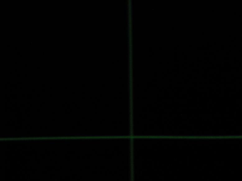

Rittberg
Posted: Sat Jan 12, 2008 7:56 pm    Post subject:
Reinier thanks again,
After reading carefully your instruction let me answer:
> optical focus? < - It’s perfect, I already done it by using the method of moving a piece of paper away/closer….
> astig? < The picture was taken from the mid point.
>EM-focus < the best focus is around 39 - 42 %, I can see that the focusing is changing while going upper or lower the mentioned figures.
I take a new picture with a lower contrast ~ 35% (the contrast in the first picture was 73%) the blooming is nearly not visible, in order to see the green lines you have to increase the brightness on the monitor.
Thanks.
