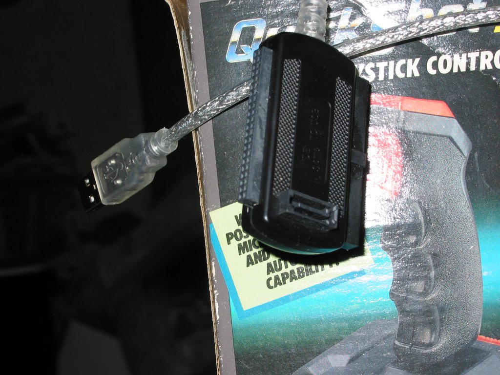

I also had a problem with the SATA implimentation on my motherboard. I ultimately had to use a SATA to USB 2 adaptor to connect the drive. I could see the file structure on the disk's. No problem. I would get to the point where PowerDVD would start then crash, hang, blue screen and sometimes if I started the PC with a disk in the driver it would get stuck in a reboot loop.
So keep that in mind. It may be hardware related too.

Posted: Thu Jan 10, 2008 7:42 pm    Post subject:
Yes that's the version ,try the software first.
The adaptor I got was a generic IDE133/laptop drive/SATA to USB 2.0.
It looks like this:
 Filesize:  168.98 KB
 Viewed:  29823 Time(s)
