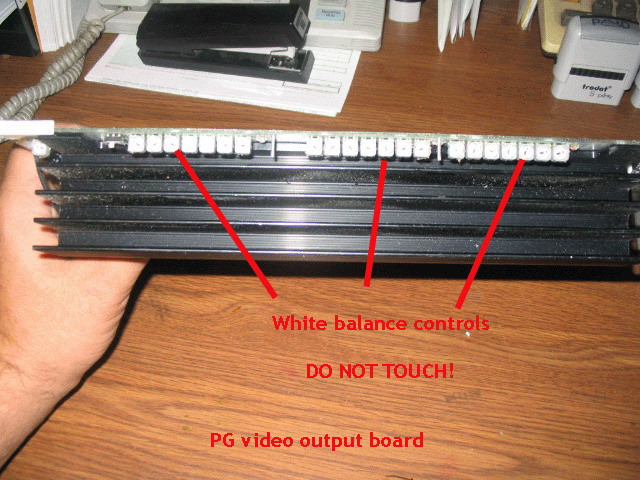

Locate the test - normal switch at the end of the video out board. (Its tiny) Most likely is in the test position. Put to normal but you may have to store the settings afterwards. Doug
See link: http://www.curtpalme.com/NECPG_Layout1.shtm
[/img]
 Filesize:  126.36 KB
 Viewed:  3729 Time(s)

If your source has a brightness function check to make sure its not turned up. Dont turn any pots!
