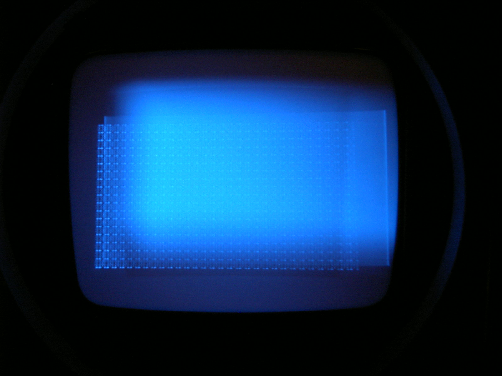

I finally had time to check this and it seems that it's not the neckbord as the problem remains with swapped neckboards. I made a picture of the blue tube, there's actually kind of a second raster which is not affected by G2, and some kind of glow uneven over the phosphor. I made this picture with G2 way down, so you can see the normal raster (displaying a focus test pattern) and also the "second raster". This seems very weird to me, can someone explain this? Is it likely caused by the tube? I also noticed that I have to crank up G2 on the blue tube in order to get it to display low-brightness detail and to be able to get colour balance right.

Posted: Fri Jan 11, 2008 5:53 pm    Post subject:
I've seen this on a Sony 1272 recently too. I'm interested in what causes it.

EDIT: Could it be that there's something glowing in the neck that shouldn't glow and these electrons then are focused on the phosphor? The second raster reacts on geometry adjustments.

Posted: Fri Jan 11, 2008 7:14 pm    Post subject:
Yes, unfortunately is does look like the tube. It could be a contamination short. Since you have nothing to lose, you could try putting the tube on its face and try tapping the neck with a piece of wood or plastic. Dont use metal. It may dislodge the contaminent. But remember there is risk involved. Even though the tube seems bad you dont want to get injured if you break the neck trying this. Also if you choose to see about having the tube rebuilt then you dont want to break the neck. Also you may want to see if someone has a Sencore to try to remove the short. Some work and some dont. I think the Sencore sheet has the specs to do the MEC tubes. I had one done years ago, but I cant remember the outcome.Your choice now. Good Luck.

Posted: Sat Jan 12, 2008 1:18 am    Post subject:
The tube does look like it has a secondary emmision problem. It can often be fixed with a Sencore 7000. There are probably other rejuvenators that will work, too.
