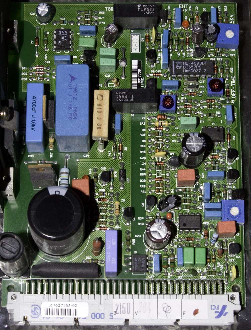

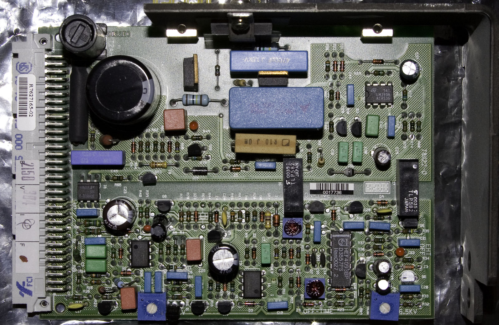

Posted: Fri Jan 04, 2008 10:28 pm    Post subject:
Hi, my curiosity resulted in pulling my Cine 9 immediately apart. The pictures are made of the EHT. I have also taken details from the Quadrupler, still inside the Cine 9: R563368 Index 0 04 36/01-M283040 (I am not entirely sure if the first digit is a 5). The number on the EHT is R7622´7165-02. The Cine 9 was manufactured September 2001. Hope this helps. Regards Udo
 Filesize:  414.12 KB
 Viewed:  8347 Time(s)
 Filesize:  459.2 KB
 Viewed:  8338 Time(s)
Posted: Fri Jan 04, 2008 10:45 pm    Post subject:
Mike, that's the HV splitter, not the quad..Very Happy
The new and old EHT boards need to get swapped as a pair, with a mod that has to be done to it so that it works in the new style sets.
The HV splitter part number changes with the new style as well, but is electrically identical to the older ones. The quad and EHT are not interchangable, new and old.
Dr Zucker, I have that EHT board. Let me run one over the weekend, and I'll be in touch re pricing, payment, repair of yours, etc.
