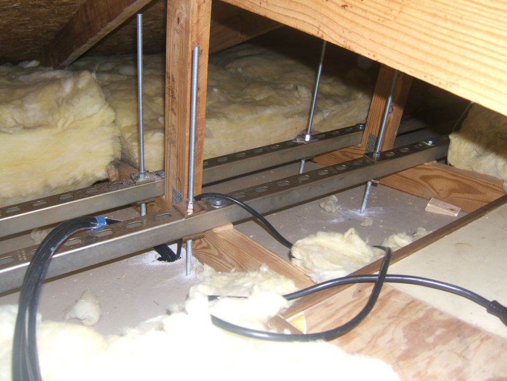

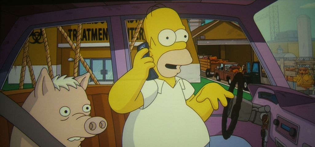

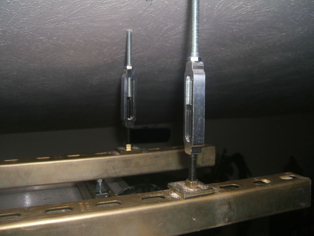

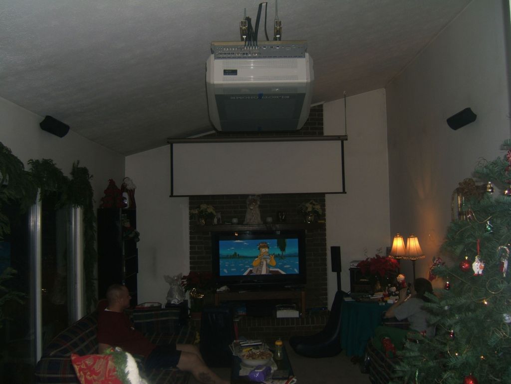

Hi all,
Hope everyone had a Merry Christmas and a Happy New Year (PC version Happy Holidays).

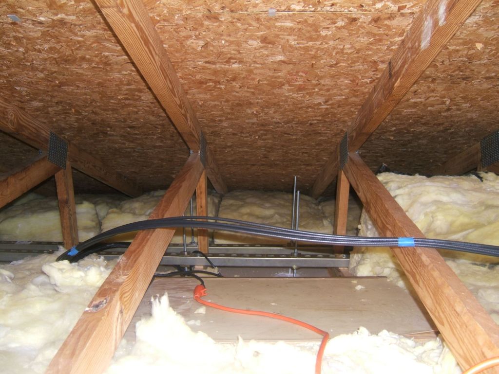

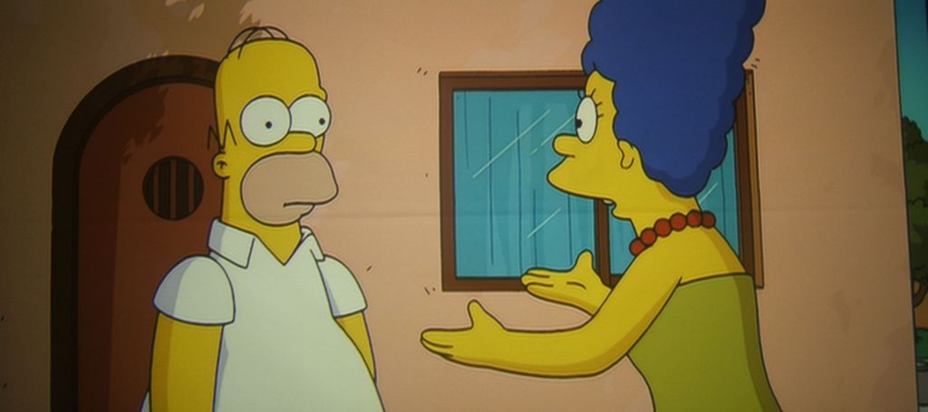

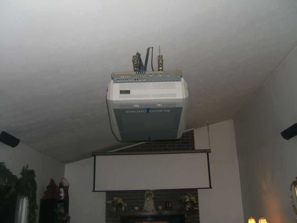

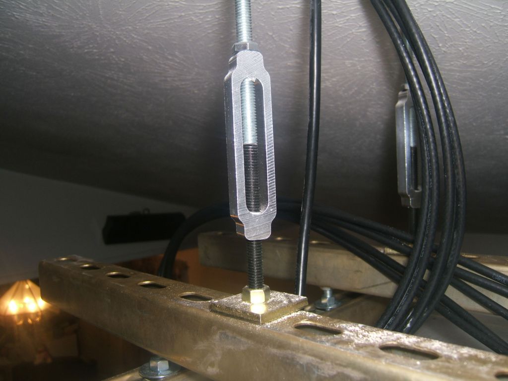

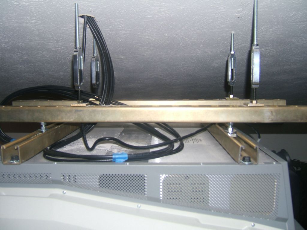

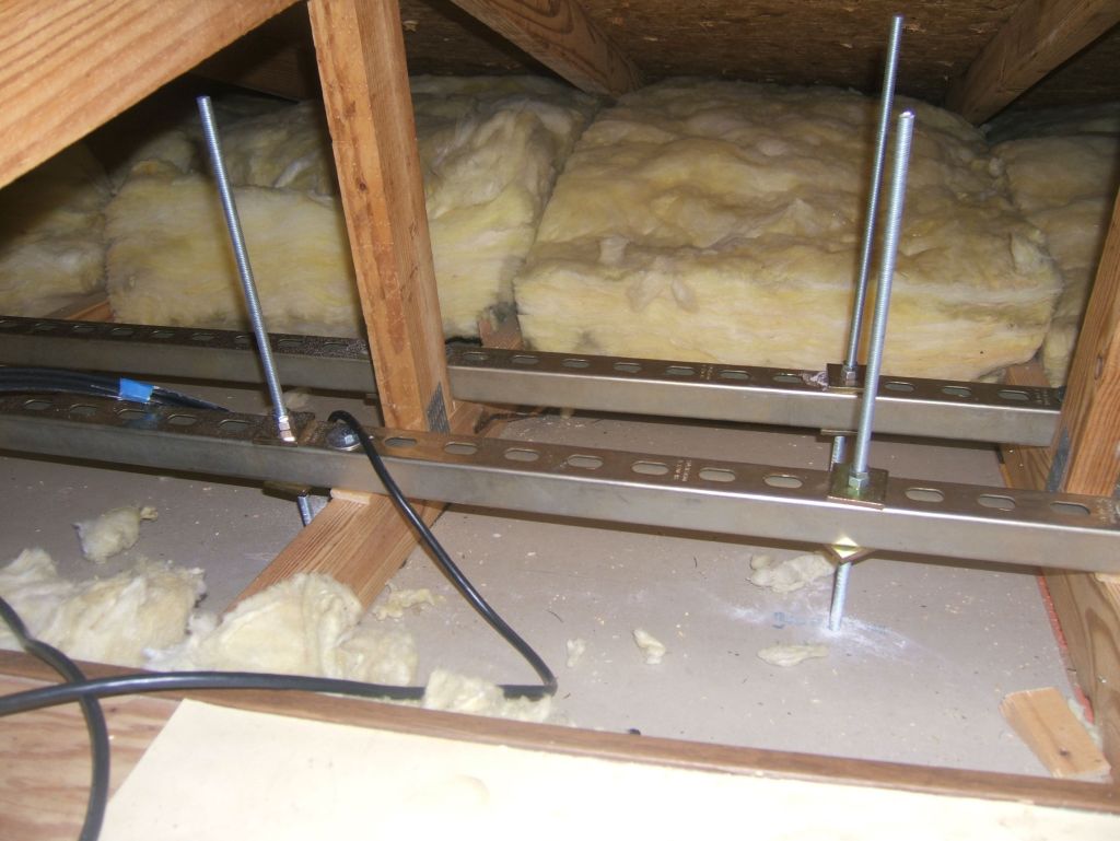

I just got my 8111+ mounted and took a few pics of how I mounted it and a couple of screen shots. This was just a quick tune up and still needs lots of work. I some how did not get the Screen square to the center line of the room. This is throwing off the right side focus and all the geometry. The screen shots are of a SD DVD upscaled to 1080i by my PS3. And yes there is a seam across the middle of the screen, but it was free. There are some good pics of how I mounted it. I used turnbuckles on the threaded rod to give me simple adjustments. You can also see how tight the working conditions were in the attic.
Still lots of work left, but at least the family and I can start enjoying it now.
John (9kids)

Looks good,
The one thing I would change would be the power cable to the projector. Extension cords running above the ceiling is a definite code violation. Run to a box right over the projector or punch a hole and put an outlet in the ceiling.

Posted: Thu Jan 03, 2008 9:00 pm    Post subject:
Zebu Fellenz wrote:
Looks good,
Erik
Yeah, that's still on the to do list. I want to put in a switched outlet in the attic, with the switch in the den, so I don't have to leave it in standby all of the time. Right now I have to run out to the garage to unplug the extension cord. I may even rewire the outlet the equipment rack is pluged into to the same breaker to help avoid ground loop issues.

Wow. The picture looks nice.
BTW: Anyone having the Blu-Ray version of The Simpsons Movie? Would really like to see some pictures of it as there should be much more sharpness in it.

I still have a few more things to do in the attic so I had let some tools up there. Of course since I left them up there I needed them to put together Christmas toys. So I decided to take the camera up when I went to get the tools. The first shot was as far as my left arm would reach and the second shot is as far as my right arm would reach (blind shots but they came out OK), the last shot is on the way out. The attic made running the cables and mounting the projector a lot cleaner, but working up there was a nightmare. Since the den ceiling is sloped too, I could only work laying on my stomach, head down, feet up, blood rushing to my head. I could only work about a 1/2 hour at a time before I would start to feel sick. At least this was a good time of year to do it, not to hot up there. So I could wear long sleeves and a sweat shirt and that helped keep the insulation itch down. Having to cut small wedges to go under the strut in the attic, to get it level, predrilling to keep from splitting the wedges and driving lag bolts, was all time consuming and not fun, but I am happy the way it came out. I am planning a hush box more for looks than sound, but it is way down on the to do list, so the idea about the pipe insulation is great for the short term.

Your mounting inside the attic looks just like mine. I was not so smart and decided to do mine in the heat of summer. We almost died up there but it was nice to get it done. I'm glad you are enjoying your setup. Like most of us, I'm sure you will never be satisfied and will continue to tweak!

Thanks everyone for your replies and comments. I was surprised that you all picked up on the extension cord, and want to assure everyone this will be resolved soon. Since I have an attic above, an unfinished basement below, and the garage is on the other side of the right side tall wall, it is pretty easy to run cable and I will be adding a dedicated outlet in the attic soon. I am also surprised that no one commented on the turnbuckles I used in the threaded rod. I thought this was a great idea and has worked great. The turnbuckles themselves are easy to find (Home Depot, Lowes, ACE), the left handed bolts and nuts were a little more difficult to find. I found them at a small old hardware store, but I am sure you could order them on the web.
