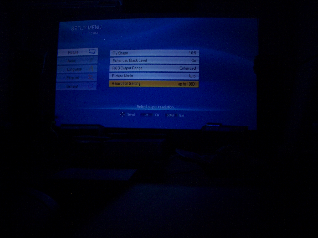

1080i. No issues.

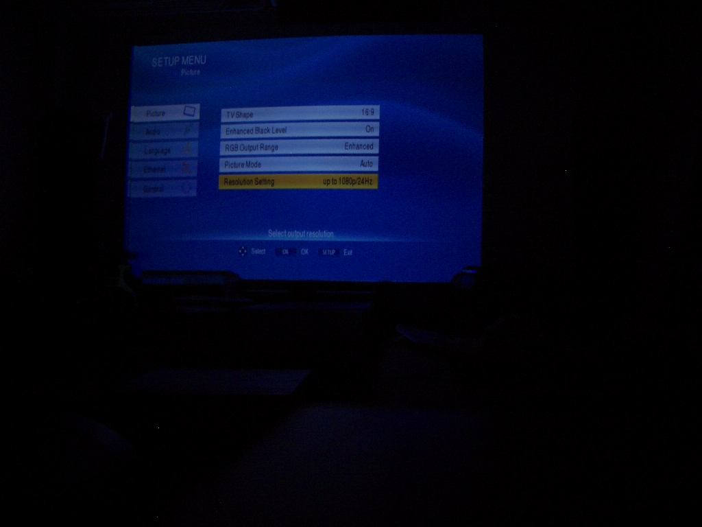

1080p/24. Picture looks bright enough, but obviously strobes. :)

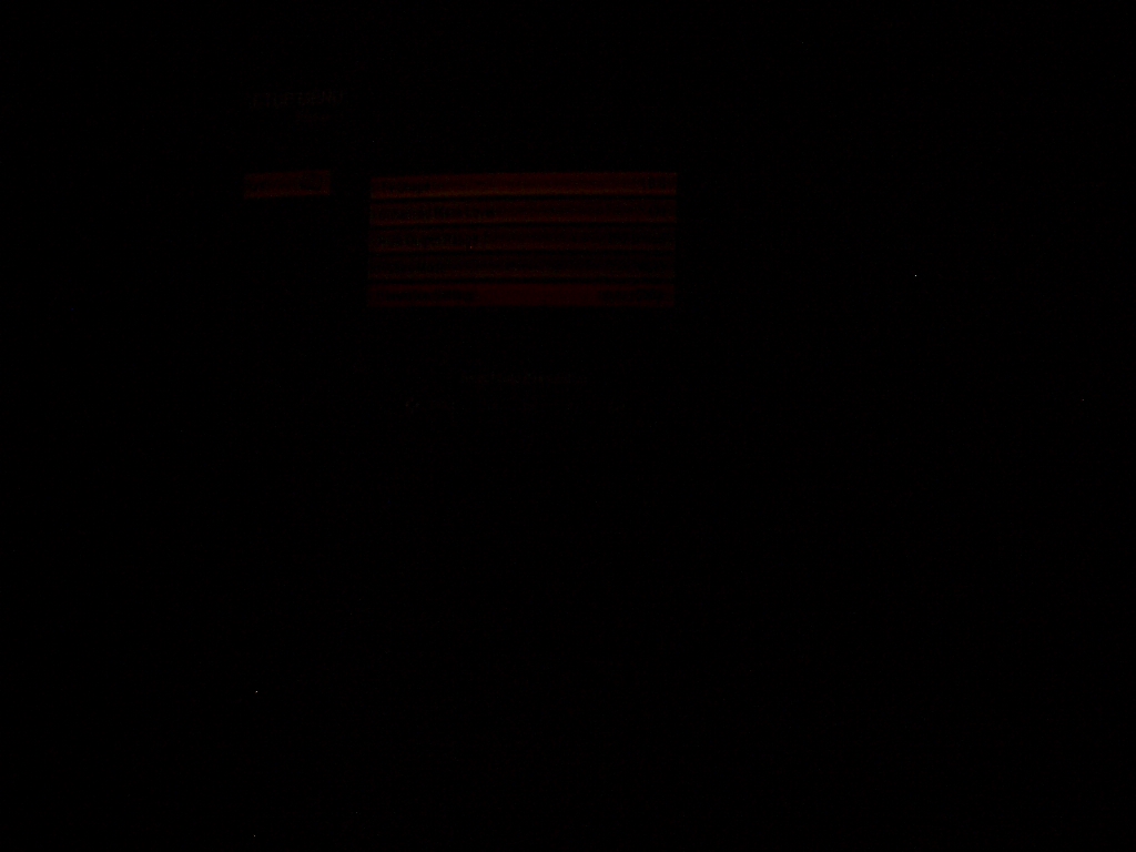

1080p. Too dark; visually appears as if I turned contrast from 70 down to 30.
