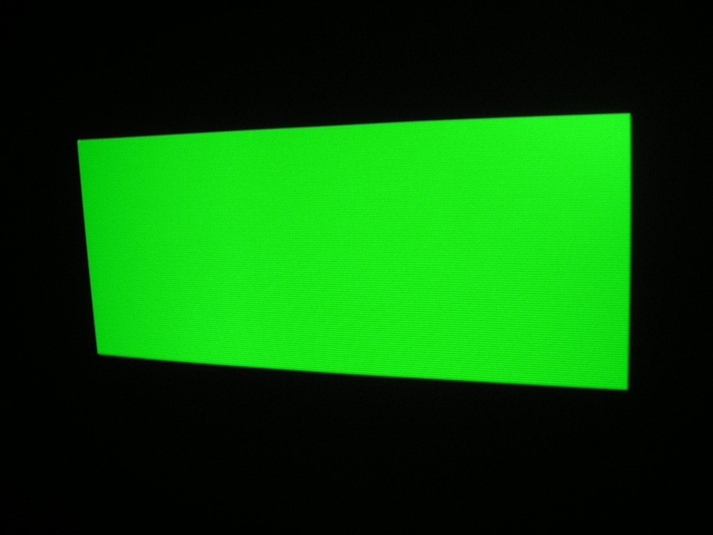

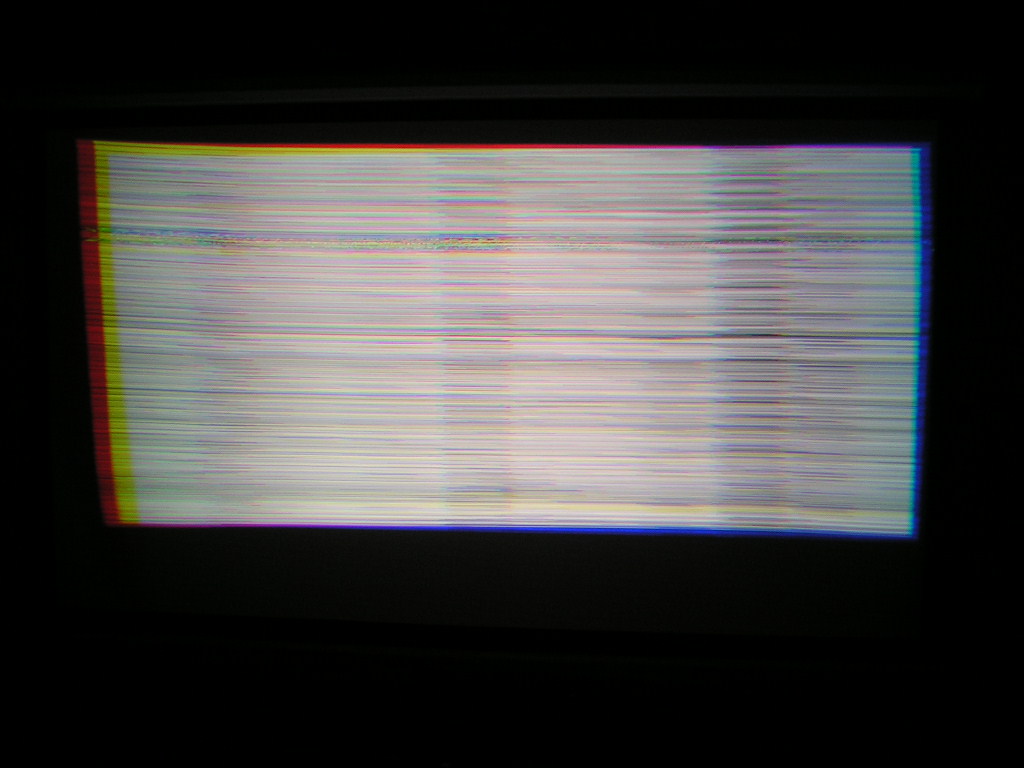

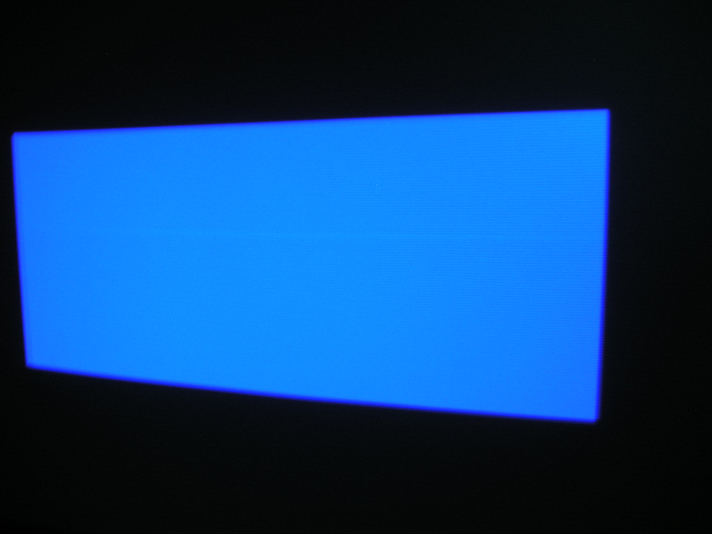

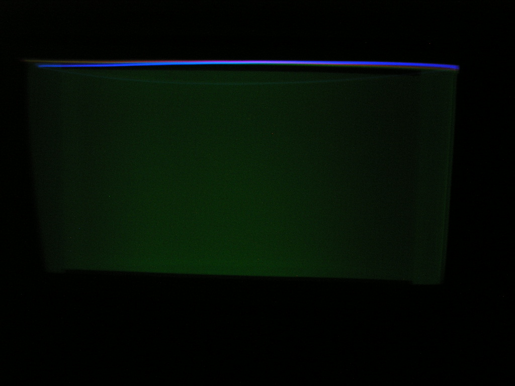

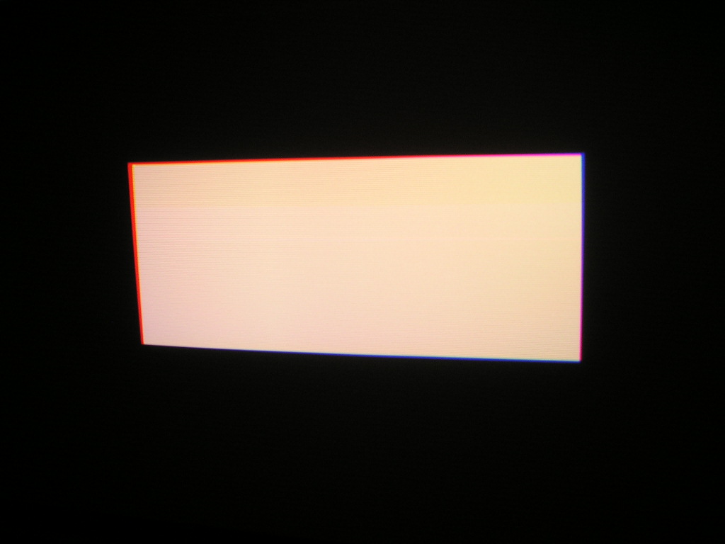

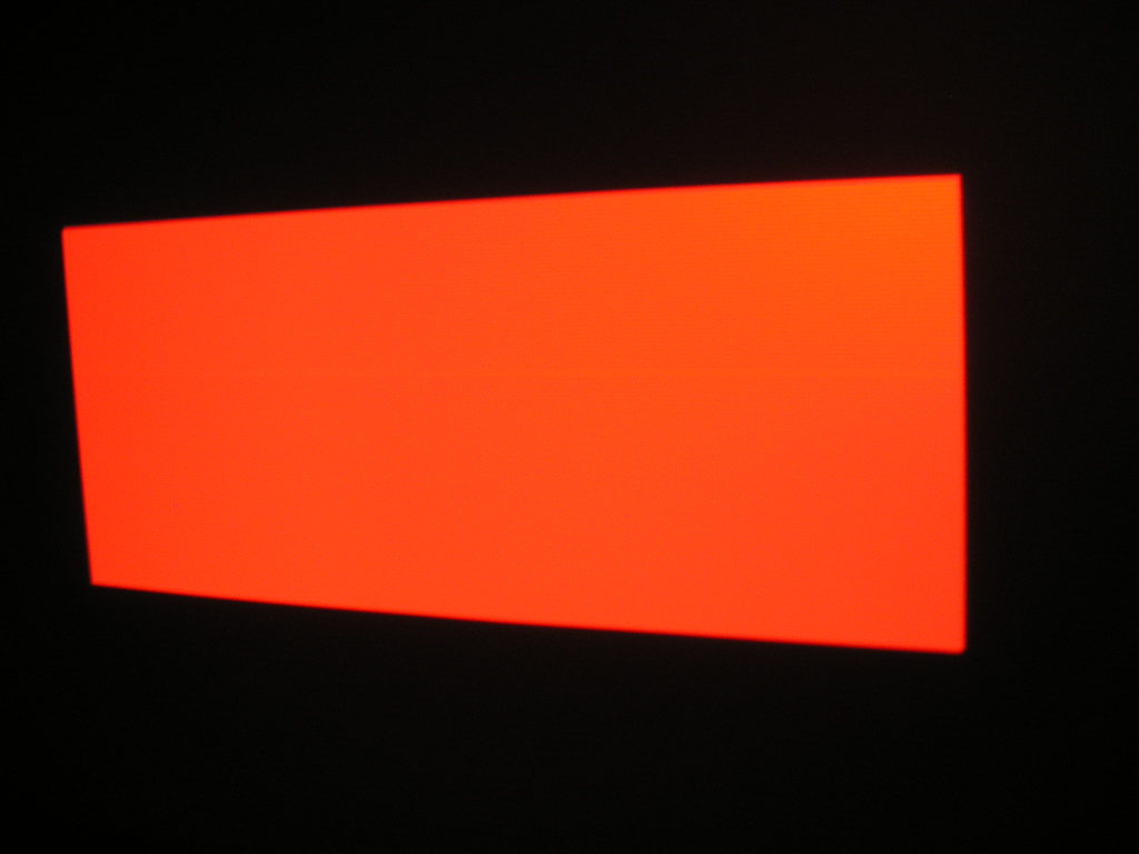

During warm-up and after, no sync, or very difficult (only on video input). White balance is bad, black balance too. Black screen is green ! always. There's a line near the middle of the screen, we can see it easily on white screen. It is strange because line is on blue and red but not on green !
Thanks for all informations !
Line on white screen
 Filesize:  101.87 KB
 Viewed:  7662 Time(s)
Line is on red screen
 Filesize:  136.18 KB
 Viewed:  7663 Time(s)
Line is on blue screen
 Filesize:  122.95 KB
 Viewed:  7664 Time(s)
Line isn't on green screen
 Filesize:  109.6 KB
 Viewed:  7665 Time(s)
 Filesize:  138.17 KB
 Viewed:  7671 Time(s)

You could have a bad system or deflection board, but try clearing the memory and input a new signal entry. THe line is due to too much convergence, usually V linearity, V lin balance or pin or key and the balance of those as well.

Now, on red, line is black. All is set at "0". Always this green on black screen, it seems it's G2 problem. How can I modify G2 on PG9200 ? There's no pots like PG6100 for example ?

I wouldn't start tweaking on G2 or pots. If you did you will have more problems then what your seeing now. Once a signal is entered and stored this will usually be corrected by storing AKB levels. This is located in the info menu but you need to read and understand it.
