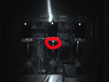

Okey, so now I recorded the arc.
It is seen within the green tube so it is not a HV lines issue.
In the attached picture, I have marked with a red circle where the arc can be seen.
The url is a small video where the arc can be seen (its only max 3 sec long). You can hear the pop and if you look closely where the red circle marked the spot, you can clearly see something happening.
URL to the videowww.bredbild.se/arc.wmv
Any ideas what might cause this?
Also, on the neckboard there is a green led for each. I THINK that they have something to do with AKB (or what it is called), is this correct? I notice that when I start the projector, only the green tubes green led is lit up all the time. The red and blue are sort of blinking a bit in the beginning, but the green tubes is lit up all the time. Is that a problem?
I am very grateful for any ideas and thoughts on this!
/Anders
Red circle marks the spot to look for the arc

Posted: Sat Dec 29, 2007 4:13 pm    Post subject:
Could be a bad neckboard or tube socket. Did you try swapping the neckboards yet ? There all the same. See if the trouble follows to another tube.

Posted: Sun Dec 30, 2007 1:07 am    Post subject:
Swap the neckboards, there's nothing to adjust. Make sure you don't bend a pin when putting the sockets on.
Contamination like this in a tube is indeed rare, but possible. If it is the tube, there's nothing to do but change it. you can try putting the set lenses down, and gently tapping on the neck while the set is on to see if the contamination will loosen and fall into the bottom/front of the tube, but it's unlikely that will work.
I've seen a couple of new tubes and a couple of VDC rebuilds do this, and standard CRT 20" sets used to do it once in a while when I worked at the TV shop in the 80s.
