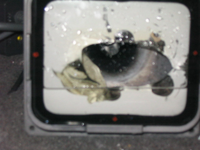

NEC PG tube, too much pressure in it. The cool thing about this tube is that the middle of the CRT face blew inward, leaving the rest of the tube envelope and safety front glass intact. Sweet! Thumbs Up
Now if I could only take pix that were in focus. Thumbs Down

That WAS lucky that only the tube face blew, thus trapping all the glycol inside. I thought when a tube imploded, usually the whole thing went kaflooey.

That's what happens with too much glycol??????? I thought it would be forced back out the vent hole. HAHA. I'd like to have seen it happen.

Interesting that the THICK tube face glass broke and the thin outer glass didn't. We've seen any number of the other way round breakages.

Maybe the vacuum in the tube helped it break to the inside....

This is strange, the face glass should have cracked before the tube envelope. I'm wondering if the tube face could have etched and weakened. Use a dud to test the chassis. Check on the video input to see if the raster was riding on the edge of the right side in the photo. Doug
