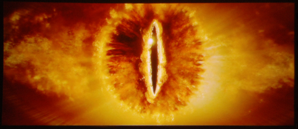

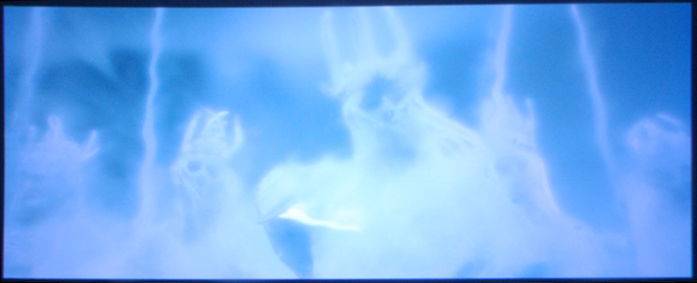

Since everybody's all about the highdef stuff now ("Look at the same eight movies we have!") I figured I'd put some standard def shots up as I get my HT going.
So, presumably, or at least hopefully, there will be a progression of quality. OK. Today's theme: Ephemeral things.
Screen's kinda bent right now, just an old hunk of foam board with a couple of layers of fabric (blackout and then a layer of pretty bright white stuff) stretched on with duct tape and tacks.

Wow look at the beautiful soft focus look, no peskey sharp corners or scan lines in those shots
What resolution are you running at.

1440x960p. The bandwidth isn't an issue with the 808s; I can't see any difference on the tubes between 1080p and 1080i. But at the moment my main astig is way the hell off because I did a total tube swap, so it's soft. And the optical focus is rough at best.
Still, it's resolving 1440x960 if a bit soft all the way around. Full white/black hashes aren't totally sharp but with 720x480 upscaled that's not necessarily a bad thing.

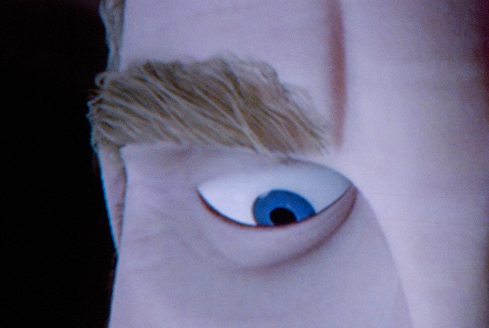

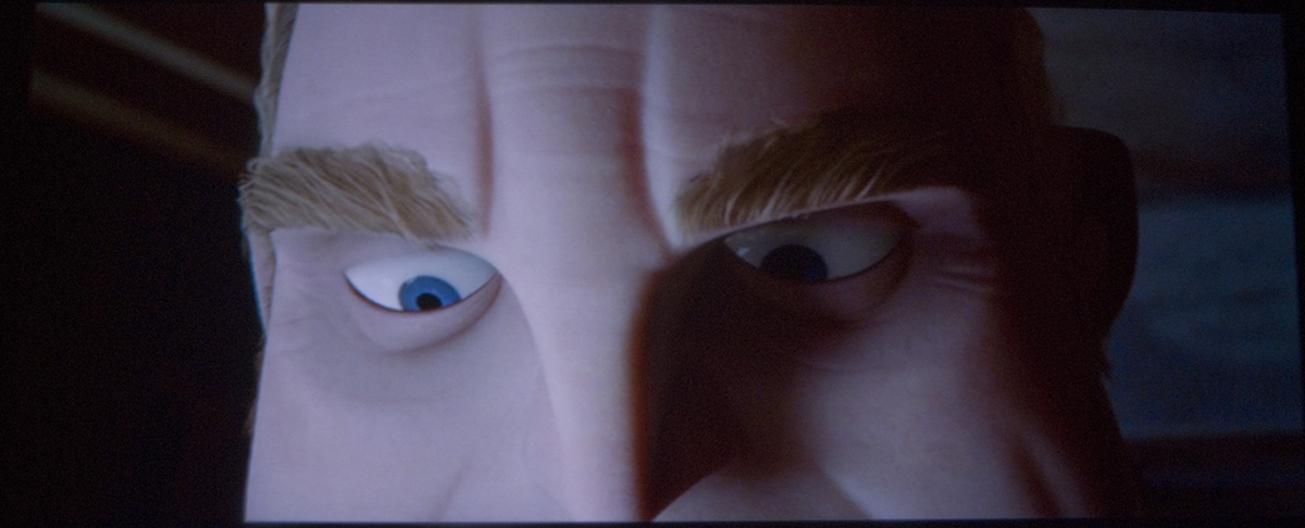

Tonight's theme: CG movies which look surprisingly good in SD.
The second picture is a zoom, not a crop; same frame. There's some noise from the camera; I shot at high ISO as these were hand-held 1/3rd second exposures anyway. I actually had to give up on a night scene because it was too damned dark, even though it was easy to see in real life. Now that's black level!
