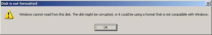

If I reboot with either a Blu-ray or HD DVD disk in the drive it will repeatedly try to read the disk, but never visually errors out yet continues to try over and over again.
If I eject the disk and close the tray again it tries to read it once and errors out with the following message:

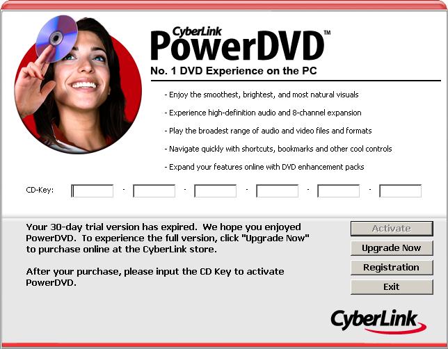

Ok, so the Cyberlink Advisor continues to report the software isn't present when it is installed. I decided to try and manually launch it and get prompted to register online. Took a couple of attempts, but I was successful. Still, the Cyberlink Hi-Def Suite shows no software.
Giving up on that function I drill down to the C:\Program Files\Cyberlink\PowerDVD folder and launch the software from there and get the following response saying the 30-day trial has expired. Hmm, just installed on a clean drive with a freshly installed operating system and driver set and 30-minutes later the Cyberlink software says its been 30-days and now expired.
I am thankful to the wife for getting me this for Xmas, but its an RMA in the waiting. I'll go buy the Samsung BD-P1400 for $270 and hold off on a second HD DVD player. What a waste. Crying or Very sad

Oh, there is no CD key. When you install from the Cyberlink Hi-Def Suite it uses a key that is a completely different format. Cyberlink really has some polished software. NOT

Have you installed the UDF driver for the HD file format? I was having problems getting the X-Box 360 drive to read disks untill I installed the UDF driver.

The attached Windows XP UDF 2.5 driver should work for both Blu-ray and HD DVD discs
(try AnalogRock's driver first though)

I will install the UDF driver and see what comes of it. The way the Readme file relates, this is the format that Toshiba uses for HD DVD. What about Blu-ray? Also, how would this driver, which would enable the identification of a specific filesystem on a disk, relate to the Cyberlink HD Adviser reporting no software player being present, the manual launching of PowerDVD reporting 30-day trial has expired (had only been 30-minutes), and the fact that the only software that will play back regular DVDs is Media Player.
If nothing comes of the UDF driver I'll try this under Vista. I have trial versions of all of the Vista versions, but somehow I think I'll run into the same 30-day trial has expired response from Cyberlink, and no software installed by it Suite launcher.

The UDF driver is part of windows. You have to go to Windowsupdate after installing the drive and three files will be added. You have to have this for windows to read the drive.
If you don't have a "legal" windows install you will have to manually put the UDF driver on your system as pointed out.

I reformatted the hard drive and installed Windows XP, SP2, etc. cleanly. I then installed the software that came with the drive.
The software that came with the combo drive is not just PowerDVD, but rather a suite of software. That suite of software had what I guess you might call a master key, which is in another format than what PowerDVD would use.
Hey, I installed the UDF driver and with a Blu-ray disk (Casino Royale) in the drive I can access the contents. I had similar success with an HD DVD (Batman Begins). With this little bit of success, I ran the HD Adviser for both formats and still no software player was found.
I got a little curious and navigated through the Cyberlink CD and inside of the PDVD folder I noticed the *.reg for the two formats. I merged them into registry and re-ran the Adviser and now it reports as having a software player. Shocked

Yes, all legit. The software is installed, but when I manually launch it its trialware expired. I've got to try and call Cyberlink and LG today. Reading Cyberlink's forums tells a tale of no support for OEM bundles, but I'm apparently not the only one running into problems. Curious, why have me go through a registration process if they will not support it?
