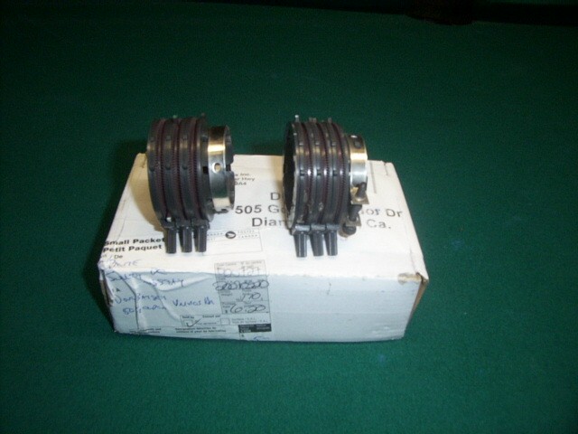

Posted: Thu Dec 13, 2007 6:58 pm    Post subject:
2-4-6 pole that fit the 10PG.
 Filesize:  68.93 KB
 Viewed:  5615 Time(s)

Doug
Those look like NEC magnets. Did NEC make them? What are they used on. Where can you get them?
Deron.
Gino
Joined: 22 Apr 2006
Posts: 1363
Posted: Fri Dec 14, 2007 7:05 am    Post subject:
Deron, Doug did say 10PG
They look just like the ones on the Marquee too
Posted: Fri Dec 14, 2007 1:48 pm    Post subject:
The 10 PG tubes have the same neck diameter as the E'homes, which is where those 6 poles came from.

Gino
Yeah, I did catch that he did say they fit a 10PG, but why does my 10PG not have them?
Curt
I did find out I was lucky in that way, that E'home stuff would swap over to my 10PG. The extra astig magnets I'm using are off some 8XXX Marquee's, or were they from some Barco's I had Rolling Eyes
It would be interesting to know if what I was able to do to the my PJ's flare, spot shape and size is repeatable with other PJ's. Someone should try it, it only took me a half hour to set the extra set to the null position, install them and put up a pattern and adjust them. I did go back and forth between both sets of astig's to get the better results.
Deron.
dbaisey
Posts: 821
Posted: Fri Dec 14, 2007 10:27 pm    Post subject:
Deron,
When the 10 PG was made they didn't have the 6 pole. It was basically the 9PG chassis with 9" tubes. The Plus and Extra had them but 7.5 - 8" and went along with the edge separate focus and electronic astig. With the yokes in stock location the 2-4 did ok. Doug

Doug
So those are too small in diameter to fit the 10PG tube neck, I would have to go with some six pole astig's off a Marquee.
