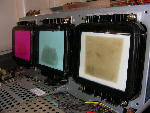

Howdy everyone !
Anyone has an idea of what these strange stains on the green and red tubes are ? (I know, I know, blue tube is totaly toasted Wink) Are these stains, fungus or wear (or what) ? Shocked Very Happy
Cheers !

My vote goes for fungus. I still see wear on the tubes however it doesn't look too bad.

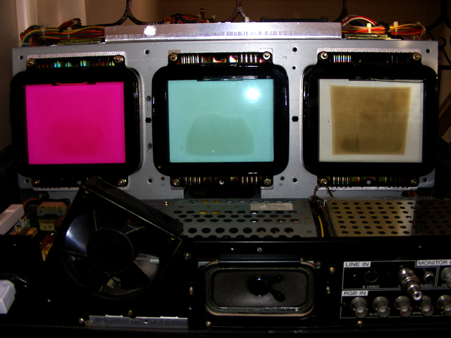

OK, now that you took a shot from a less oblique angle, that definitely looks like the infamous 'fungus' problem. Curt just happens to have a page all about it and the removal of said fungus.
http://www.curtpalme.com/Fungus_Removal1.shtm
This look anything like your tubes?

I nominate that blue tube for a sink covered in lime scale look award. Razz

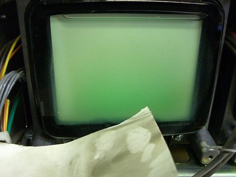

Fungus..Did someone say fungus...Here you are...And guess what color is that tube?
Here is more pictures:
http://www.dvdplaza.fi/forums/showpost.php?p=860713&postcount=61

Posted: Tue Dec 11, 2007 10:44 am    Post subject:
Turn it on. Put up an image.
If it is blurry at those spots=fungus
If it is focused but darker=burnt

oh crap that blue tube is gone, haha

That blue would drive me nuts. I know you didn't want comments about it and I apologize but I'd be thinking more about that blue tube than I would growing single celled organisms in the other two. Looks like keystoning was a little funky for a long time too.
