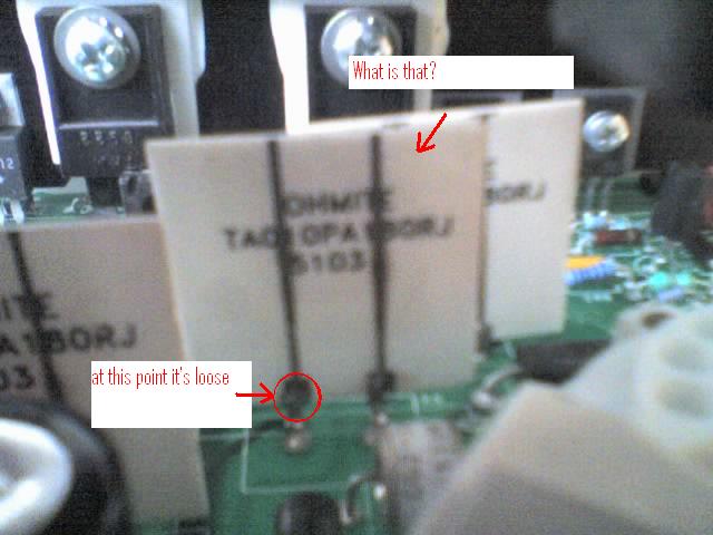

I actually found something wrong on the green CRT card. One of these white sqares (I've got no idea what this actually is) has one of it's pins loose. Can I solder that or should I look for a replacement part? Sorry for the stupid question but I've never seen such a part before.
chillman
Joined: 09 Apr 2007
Posts: 134
Location: Germany, Bavaria
Posted: Fri Dec 07, 2007 1:58 pm    Post subject:

The white square things are power resistors (180 ohm, 10W, NON-INDUCTIVE). They are part of the video amplifier. If you can resolder the terminal to the part, do so. It is probably silver solder or some other high temperature solder, though.

Thank you for all your help, the AmPro works again! I resoldered the pins, so far the AmPro is working. Just one more thing: when playing around with the remote I accidently switched off the red tube... Can someone tell me how to switch it back on? Thanks a lot!
